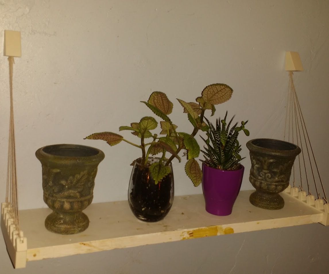

Now you just have to glue it all together! Get your hot glue going, and build your prototype up. Note for mine that I used a lot of extra glue to make it more air tight. Now you'll have your practically free prototype! As with mine, I found out that I needed to raise the shelf. The least expensive prototype I could have got for it would have cost $40+ and taken 2 weeks to get to me. Instead I fixed my model, and had it printed in the final material ready to go!
Step 6: Optional Final Step
Now you have your prototype, and you can make any revisions. You could even make a final version using this method! Or you can get it 3D printed. I had mine printed in Polished Alumide and Glossy Black Ceramic through Shapeways.
