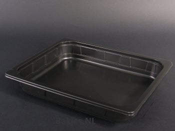

non-metalic reservoir

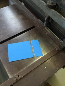

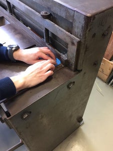

Step 2: Cutting the PCB
Cut the PCB to your dimensions.
You can cut it with guillotine cutter for paper or steel

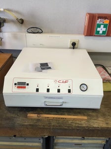

Step 3: Illuminate
Pull the tray out and then open it

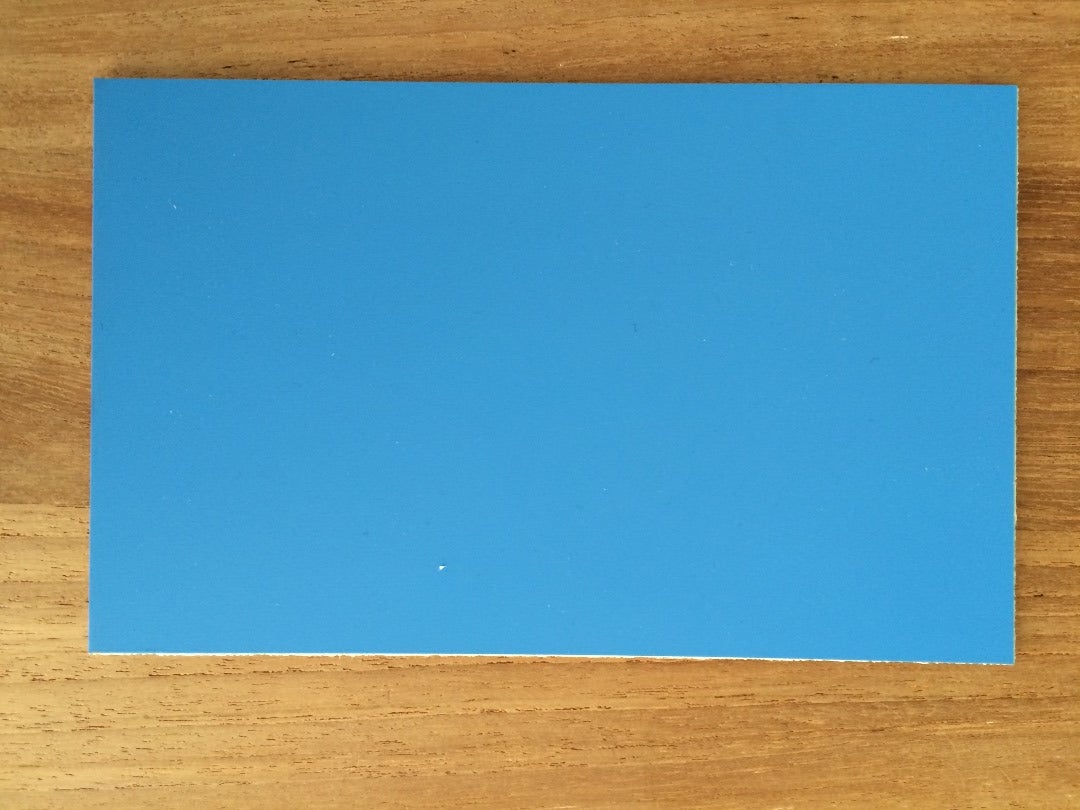

Remove the blue protective layer of the PCB
Put the print with the printed side against the copper side of the PCB
Put this against the lower glass plate
Closed it
Turn on the machine
Turn the vacuum pump on and let these go up to 0.5 bar
If this is reached, slide the tray back and turn the lights on
Put the timer on 3 min

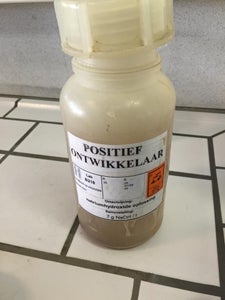

Pour the positive developer in a reservoir
If the timer of the lightbox is 0, remove the pcb and put it for 1 min in the developer
Rinse the PCB thoroughly with water, until all the developer is disappeared.
Make sure you put on the gloves because the developer will irritated skin

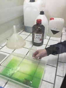

Step 5: Etching the PCB
Make sure you have the gloves and safety glasses on and make sure the room is ventilated

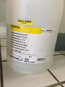

Pour 50 ml of hydrogen peroxide (H2O2) in a non-metalic reservoir and then do only 100 ml of hydrochloric acid in
Add the developed PCB in the acid bath.
The copper between the circuit must disappear completely. see movie 1 and 2
Move the container gently
This takes about 5 min.
If all the copper is off then rinse with water and dry.

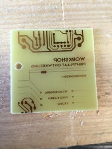

Step 7: Result
Now you see way you have to mirror the circuit that you drawed otherwise you 'll have a mirrored PCB
Like the foto
