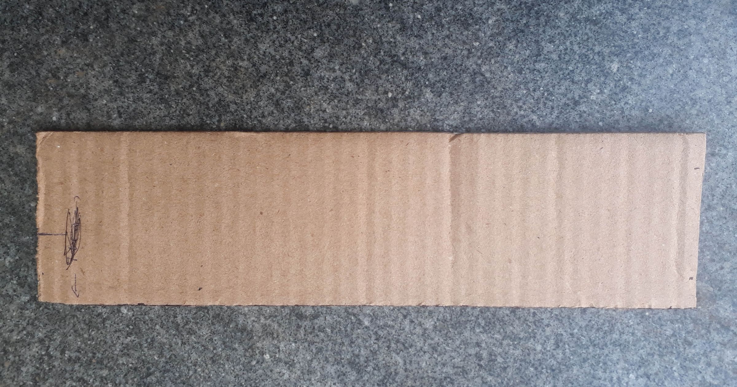

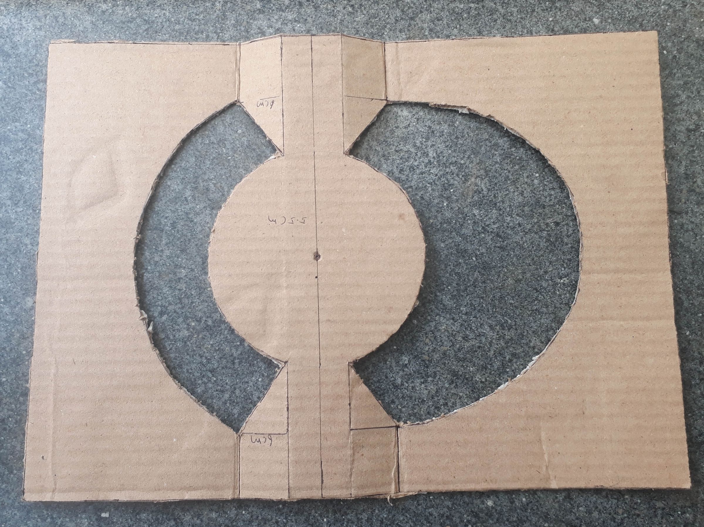

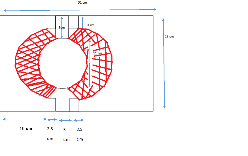

Step 5: Making Lamp Shade
- cut cardboard as per the following dimensions

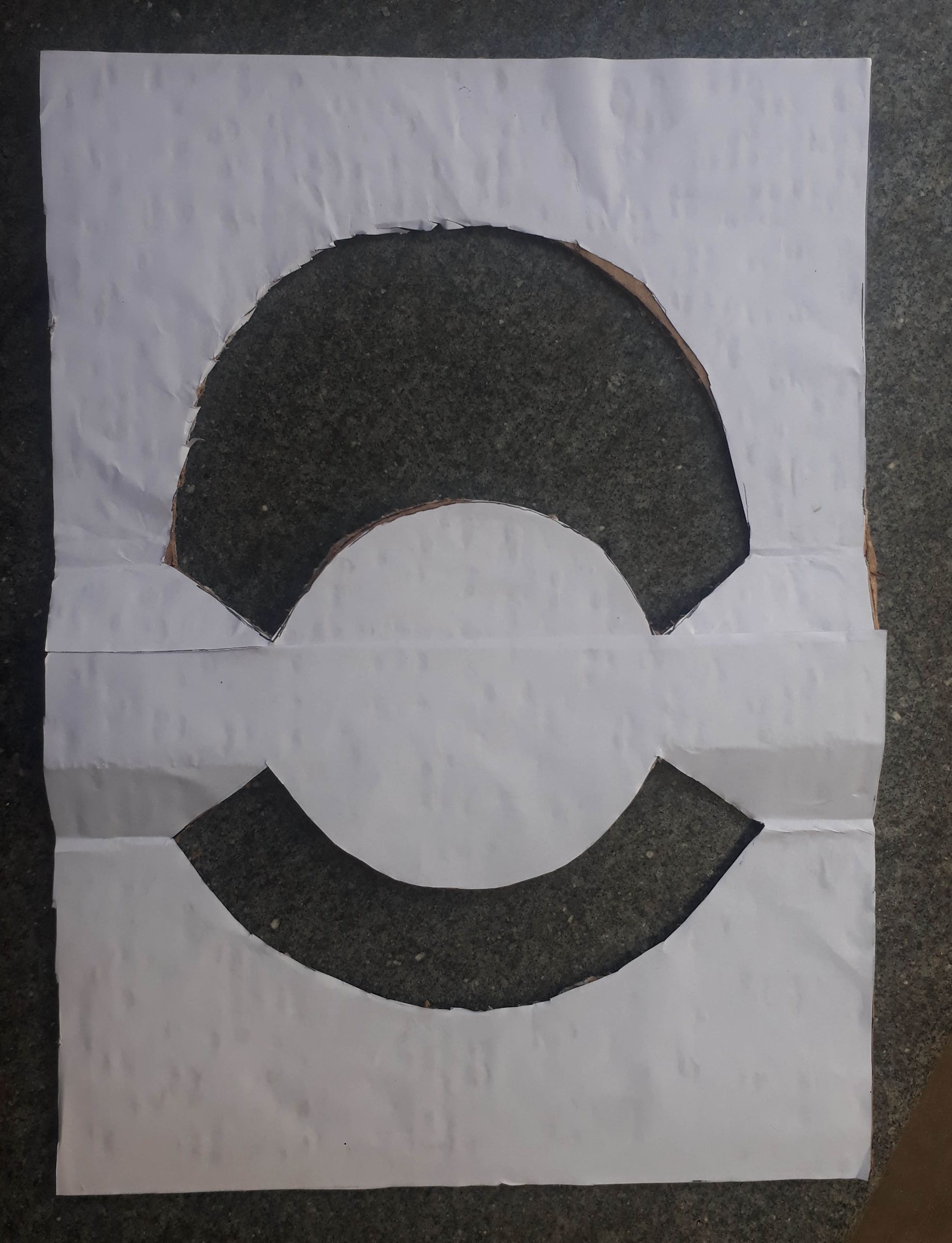

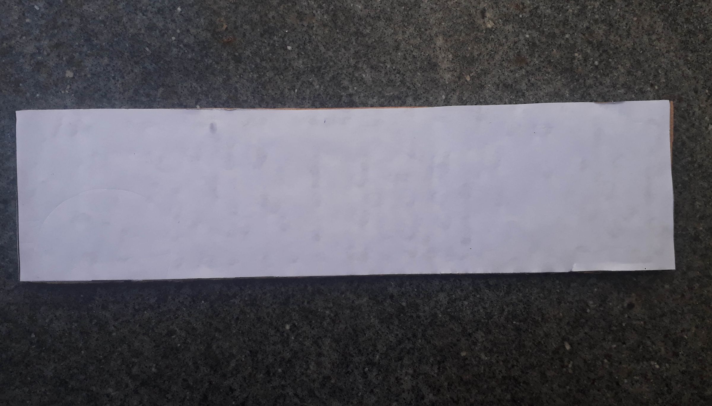

Step 6: Next Step!
Cover cardboard with white paper

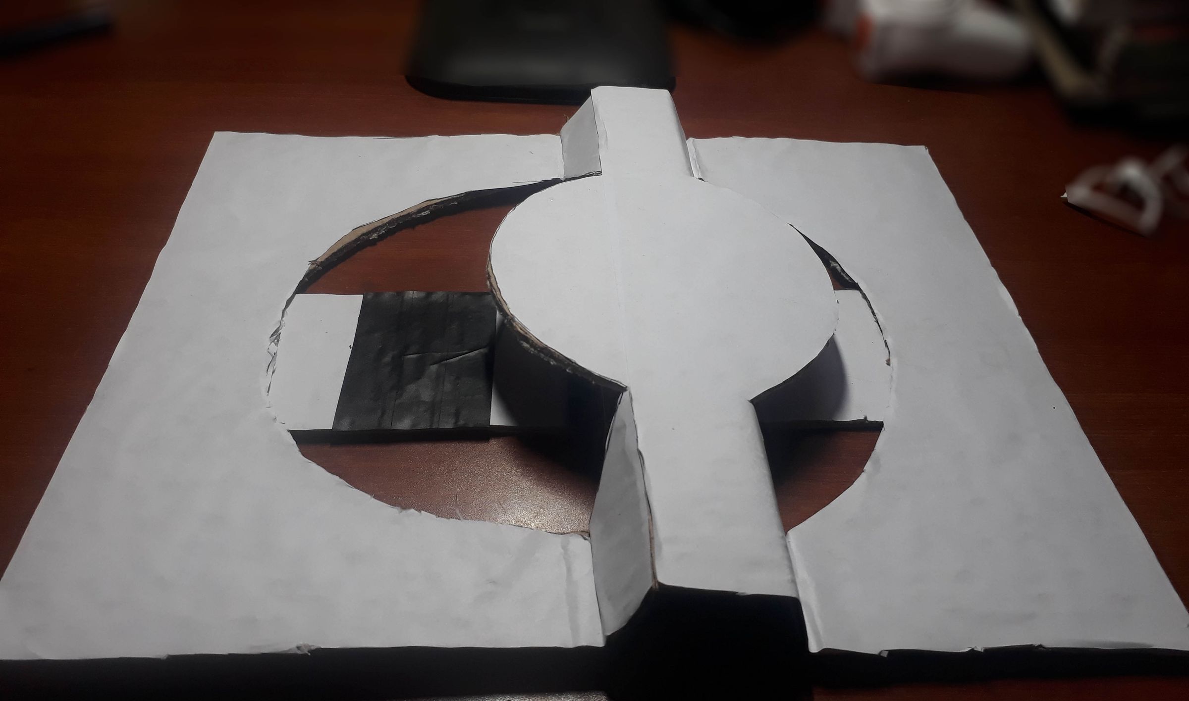

Step 7: Whats Next

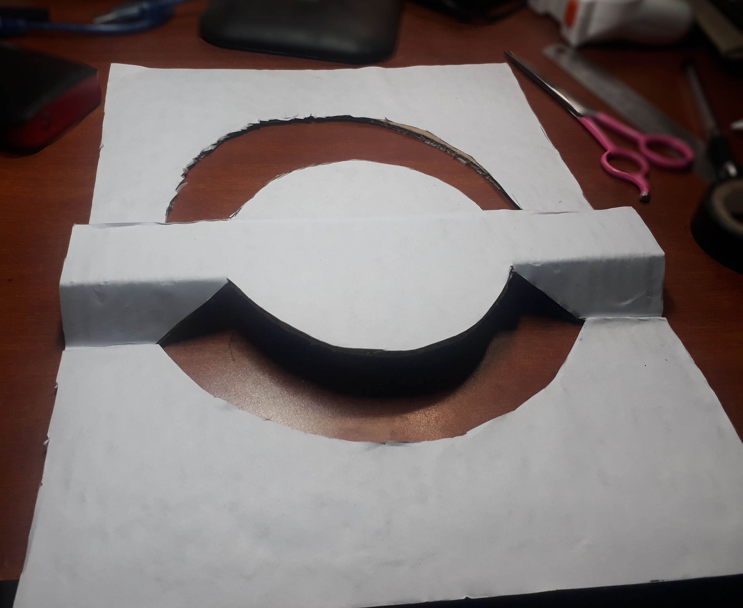

Stick arduino and sensor setup to the cardboard as per the below image
- Cover aluminium foil(Sensor) with insulation tape as below given image
- Fold cardboard as per the below image and stick it to the other cardboard piece
