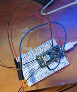

Step 2: Attach Servo
Attach the servo to your breadboard. It should have three wires. Each wire should connect to each of the following:
  • Brown wire is connected into ground
  • Red wire is connected to VUSB
  • Yellow wire is connected to your digital pin (I used D2 for my code)

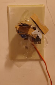

Step 4: Build Structural Components

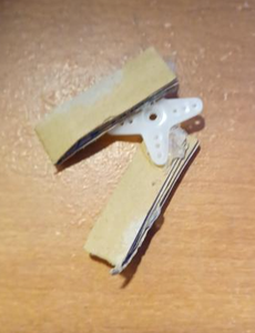

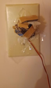

If your servos couldn't reach your light switch like mine, you can hot glue cardboard onto your light switch to extend it. If the fins are too short, you could also hot glue cardboard onto that too.
When you've tested that the servo could turn the light switch, start taping the servo into a position that can turn the light switch. It may be helpful to unplug your Argon from the power source to stop it from turning randomly. Once you've set everything up correctly and flashed the code, it should start turning whenever you're near.
