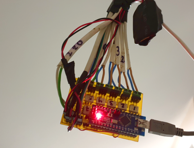

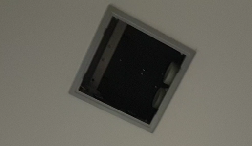

I hid the board itself in the space between the drywall and the ceiling, since there is more than enough space there.

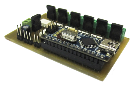

Step 6: PCB
All the components were placed by me on one board, on which screw connectors are installed for connecting wires from the lamps.

The basis of the whole device is the arduino Nano V.3 controller, but you can also use any other boards with the Atmega328 microcontroller

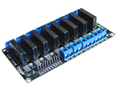

Step 10: Relay
9 years ago I did not find suitable solid state relays and I had to assemble them myself from loose materials. But at the moment it is easier to buy an 8 channel solid state relay module like in the picture than to waste time looking for these components.
