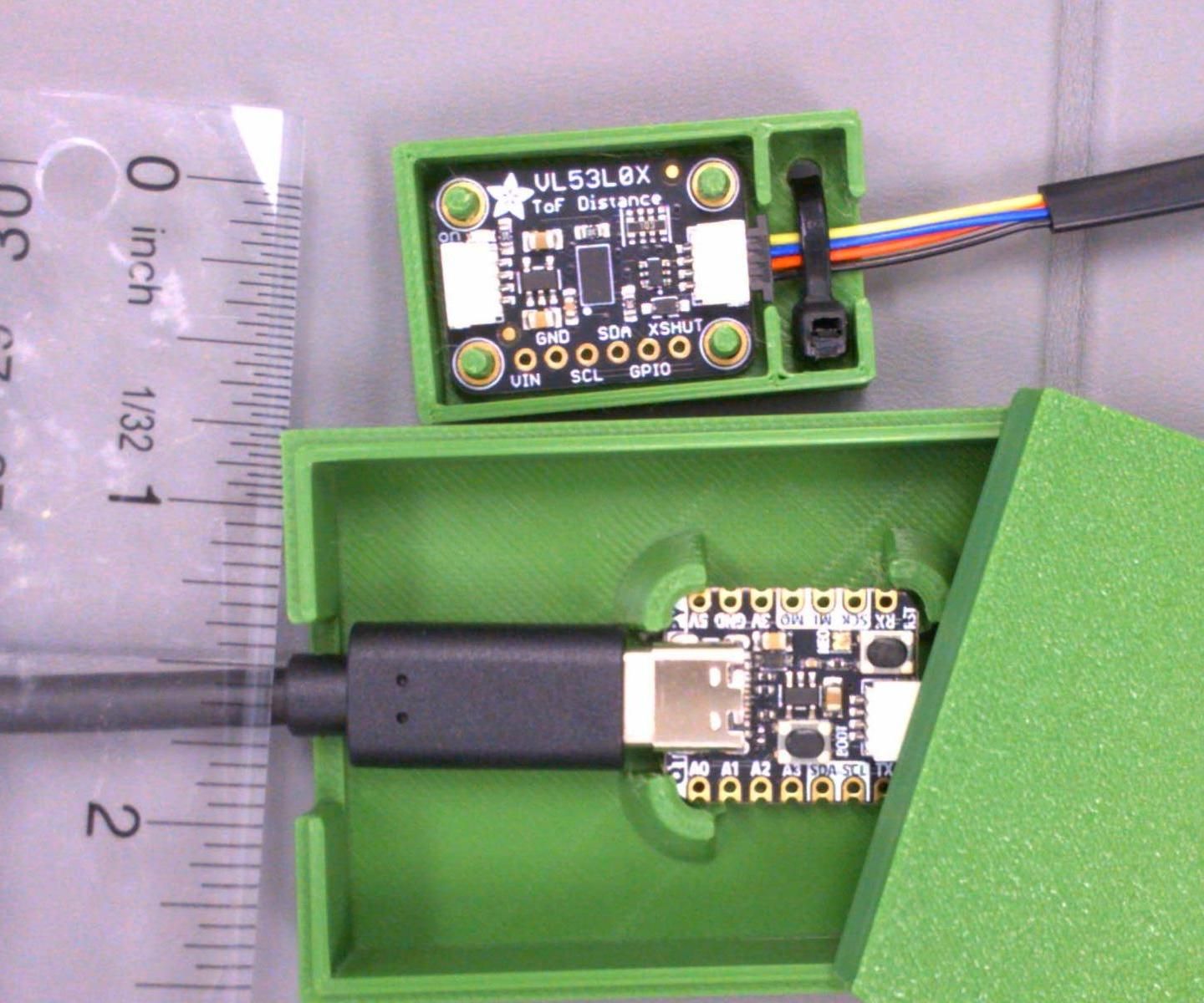

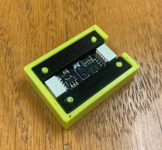

(The 3-D printing is optional. Making a case for the electronics can keep the wires in place better, protect them, and make them look nicer, but it's not required for them to work.)

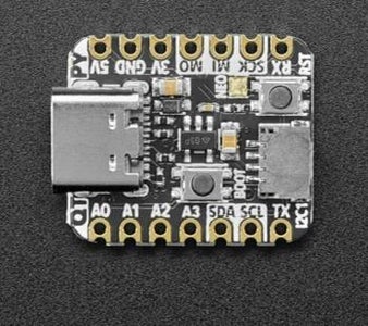

Adafruit QT Py RP2040 printed circuit board

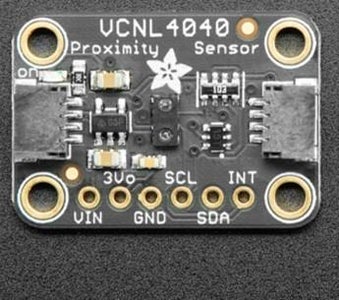

VCNL 4040 proximity sensor

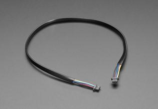

STEMMA QT cable to connect the proximity sensor to the printed circuit board

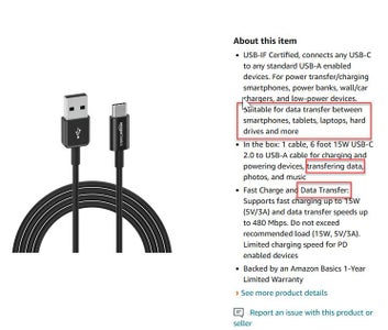

USB A to USB C cable that transfers power AND data (can also be easily purchased from Amazon, just check the listing to make sure it specifies that the cable transfers power AND data)

Connect the VCNL 4040 proximity sensor to the QT Py using the STEMMA cable (black cable with the four different colored wires exposed at the ends)
  1. Plug one end into the smaller connector on the QT Py (the word BOOT is written above it) and the other into either connector on the VCNL 4040 proximity sensor (both work the same).

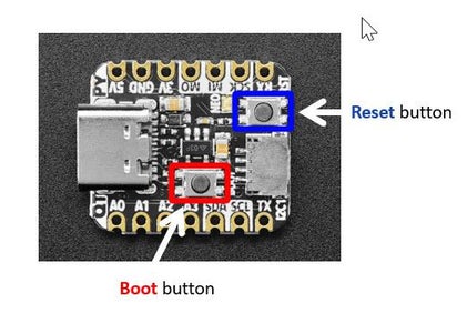

Step 2: Put the QT Py Into Bootloader Mode
  1. connect the QT-Py to your computer with the USB cable.
  2. press and hold the Boot button.
  3. press and release the Reset button.
  4. release the Boot button.
Make sure it worked!
•Look on the left where your list of drives are
•You should see a drive that says RP1-RP2 around where you’d see a USB drive pop up when you plug one of those in.

  1. Make sure you are holding down the boot button WHILE you hold down AND release the reset button. Don't release the boot button until AFTER you've pressed and released the reset button.
  2. If you don't see the RPI-RP2 drive, make sure you have a USB cable that transfers power AND data. You can't tell just by looking! If you're not positive that your cable transfers both data AND power, try another cable.
  3. Unplug and replug in your STEMMA QT cables if needed. They can get unseated.

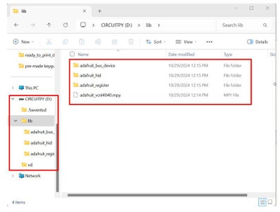

Step 7: Put Files on QT Py
•Using the search function in Windows Explorer, search for the following file inside of the adafruit-circuitpython-bundle-9.x-mpy-20240910 folder (again, different numbers at the end of the file name for you) by copying and pasting the file name in bold italics below into the search bar :
  1. Adafruit_vcnl4040.mpy
•Drag that file to your CIRCUITPY drive and put it in the lib folder
  1. Make sure you put it inside the lib folder! The computer will be looking for it in that specific location
  2. You can also copy (ctrl + c) and paste (ctrl + v) the files and folders to the lib drive on CIRCUITPY
•Repeat that process for the following items by copying and pasting the file names in bold italics belows:
  1. adafruit_bus_device (a folder)
  2. adafruit_register (a folder)
  3. adafruit_hid (a folder)
  4. neopixel.mpy
NOTE: There are two files called neopixel.mpy. One is 1 KB in size and one is 2 KB in size. You need the one that is 2 KB in size. See the screenshot for help.
