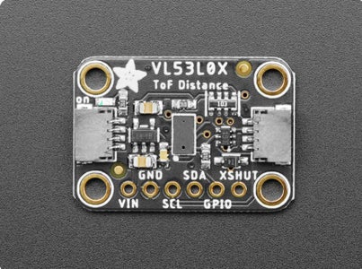

Adafruit VL53L0X time of flight distance sensor- ~30 to 1000mm

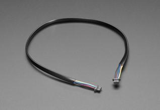

STEMMA QT cable to connect the proximity sensor to the printed circuit board

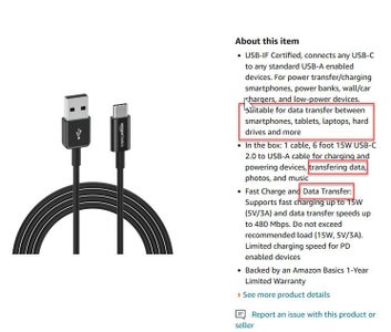

USB A to USB C cable that transfers power AND data (can also be easily purchased from Amazon, just check the listing to make sure it specifies that the cable transfers power AND data)

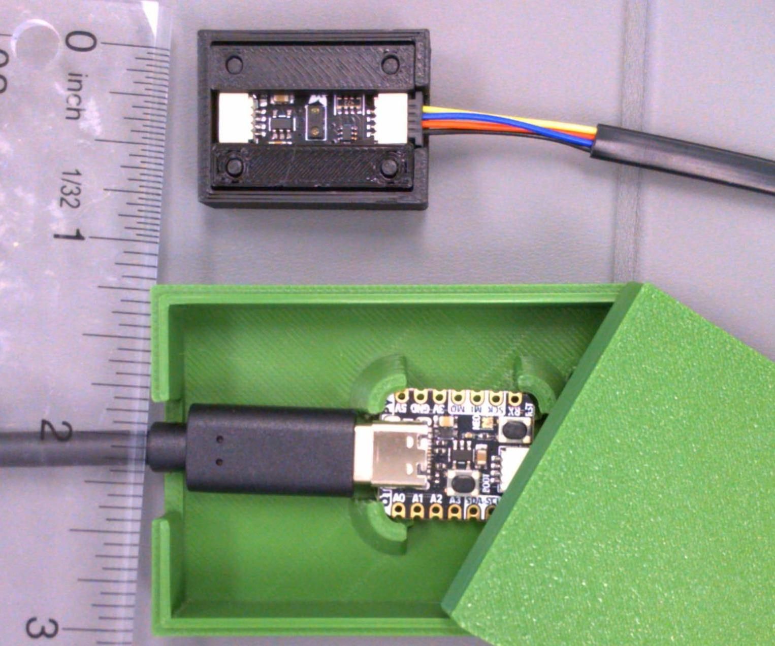

3-D printed housing 3mf file is linked below.
Modular hose for mounting (the QT Py 2040 is small, but not small enough to thread through modular hose)
See attached file for a clamp with an opening that 1/4 inch modular hose can fit into. Recommended material is ABS.

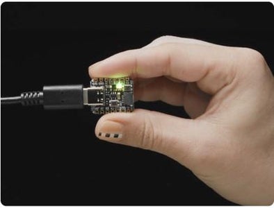

Step 1: Plug Everything In
Connect the VL53L0X sensor to the QT Py using the STEMMA cable (black cable with the four different colored wires exposed at the ends)
  1. Plug one end into the smaller connector on the QT Py (the word BOOT is written above it) and the other into either connector on the VL53L0X sensor (both work the same).
Plug the QT Py into your computer using the metal USB-C cable (small oval end goes into the QT Py, the larger rectangular end goes into your computer).
For Mac users: You might need a USB adaptor, but this setup has been tested and works on Mac!

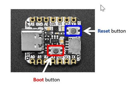

Step 2: Put the QT Py in Bootloader Mode
  1. Connect the QT-Py to your computer with the USB cable.
  2. Press and hold the Boot button.
  3. Press and release the Reset button.
  4. Release the Boot button.

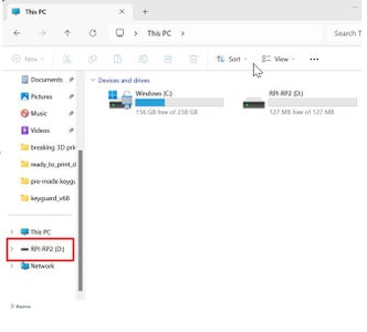

Make sure it worked!
•Look on the left where your list of drives are
•You should see a drive that says RP1-RP2 around where you’d see a USB drive pop up when you plug one of those in.
Step 3: Troubleshoot If Needed
  1. Make sure you are holding down the boot button WHILE you hold down AND release the reset button. Don't release the boot button until AFTER you've pressed and released the reset button.
  2. If you don't see the RPI-RP2 drive, make sure you have a USB cable that transfers power AND data. You can't tell just by looking! If you're not positive that your cable transfers both data AND power, try another cable.

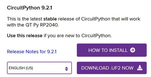

Step 4: Download Circuit Python
  1. Go to https://circuitpython.org/board/adafruit_qtpy_rp2040/
  2. You need the most recent version, which was 9x at the time of making this tutorial but is no longer.
  3. Click, "Download .UF2 now"

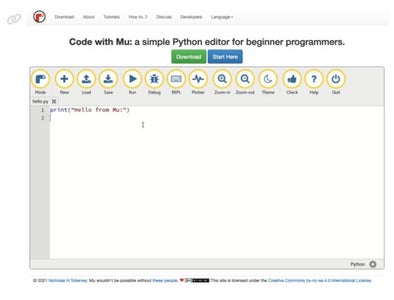

Step 10: Download Mu Editor to Troubleshoot and Customize
•Get directions for how to download Mu Editor from https://learn.adafruit.com/welcome-to-circuitpython/installing-mu-editor
•Get Mu Editor from https://codewith.mu
•Choose Circuit Python when prompted at start-up
If your switch is plugged it and set up, it should automatically open up the code. Click serial mode to see exactly what your switch is doing second by second!
