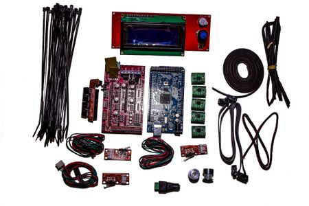

- 1 Ramps 1.4
- 3 End Stop
- 1 LCD Control Panel

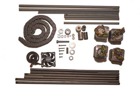

- 4 Nema 17 Motor

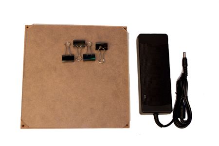

- 1 220 AC 12 DC 100W Power Supply

- 52 Igus Chain link

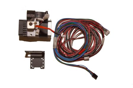

- 1 Witbox Extruder

- 2m GT2 6mmx1m Belt with pulley
- 7 LM8UU Linear Ball Bearing

- 4 Black Clip (35x10mm)

- The Stepstick Drivers A4988 come with the controller Ramps 1.4
- It’s necessary an Arduino Mega which is not indicated in the tutorial. In my case this comes in the Ramps controller pack, along with Stepstick
- The Nema 17 and Endstops cables that come are sufficient. No extra cable is required.

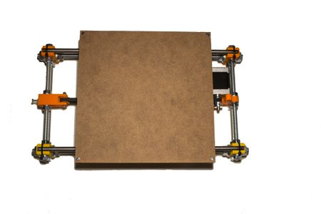

- The methacrylate base was replaced by an MDF board with the same dimensions and 8mm in height, since i didn’t find any.

- 1 Threaded Rod M8
- 1 Threaded Rod M5
- 2 Rod M8
- 1 Threaded Rod M10
The rods are sold in 1 meter bars.

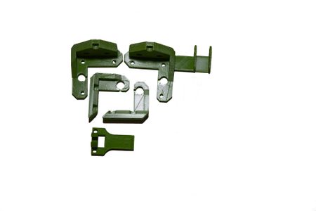

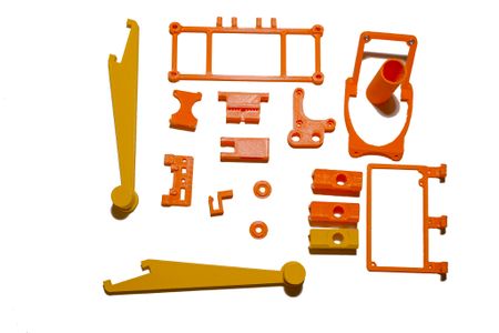

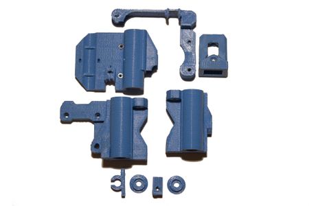

Printed parts
Printed pieces were downloaded from Thingiverse (link) ( a repository of pieces of different types for printing) and printed in several 3D printers. This is the part where you have to know someone who has a printer or buy the already printed pieces (eg on eBay) .

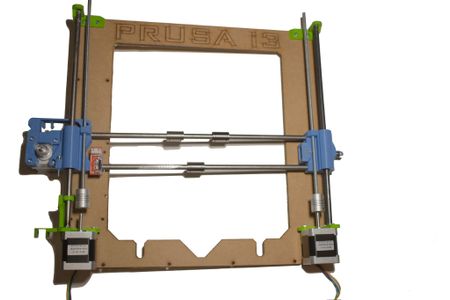

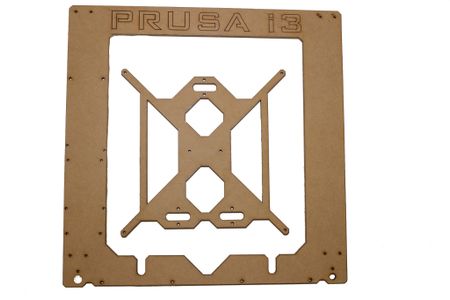

Frame
The frame was built in 5mm MDF. He was downloaded here and cut a laser cutter. May acquire it in aluminum in BQ or other companies but with a higher price. A 5 mm MDF board needed was around 3€.
Note: At this time BQ already has several parts to purchase, but the price is a little higher than being adapted for us.

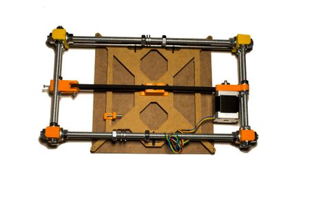

- Belt pitch - 2 -;
- Belt presets - 2mm Pitch ( GT2 Mainly ) - belt type;
- Pulley tooth count - 20 - number of GT2 teeth.
As the motors and belts are all the same, the value applies to both the X and the Y axis. In this case the resulting value is 80.

After mounting and set up everything , I realized that the frame was not sufficiently robust to withstand the filament coil (this weighs 1kg). When put in place, the frame bent enough to put away the extruder from the glass.
Fortunately, I wasn’t the first to register this problem. In Thingiverse, the user voodoopt resolved this issue by adding a support bar to the frame (link Thingiverse ). In addition to the printed pieces, are needed 2 meters of 8mm threaded rod, washers and M8 nuts. After this update, the printer was extremely stable.
