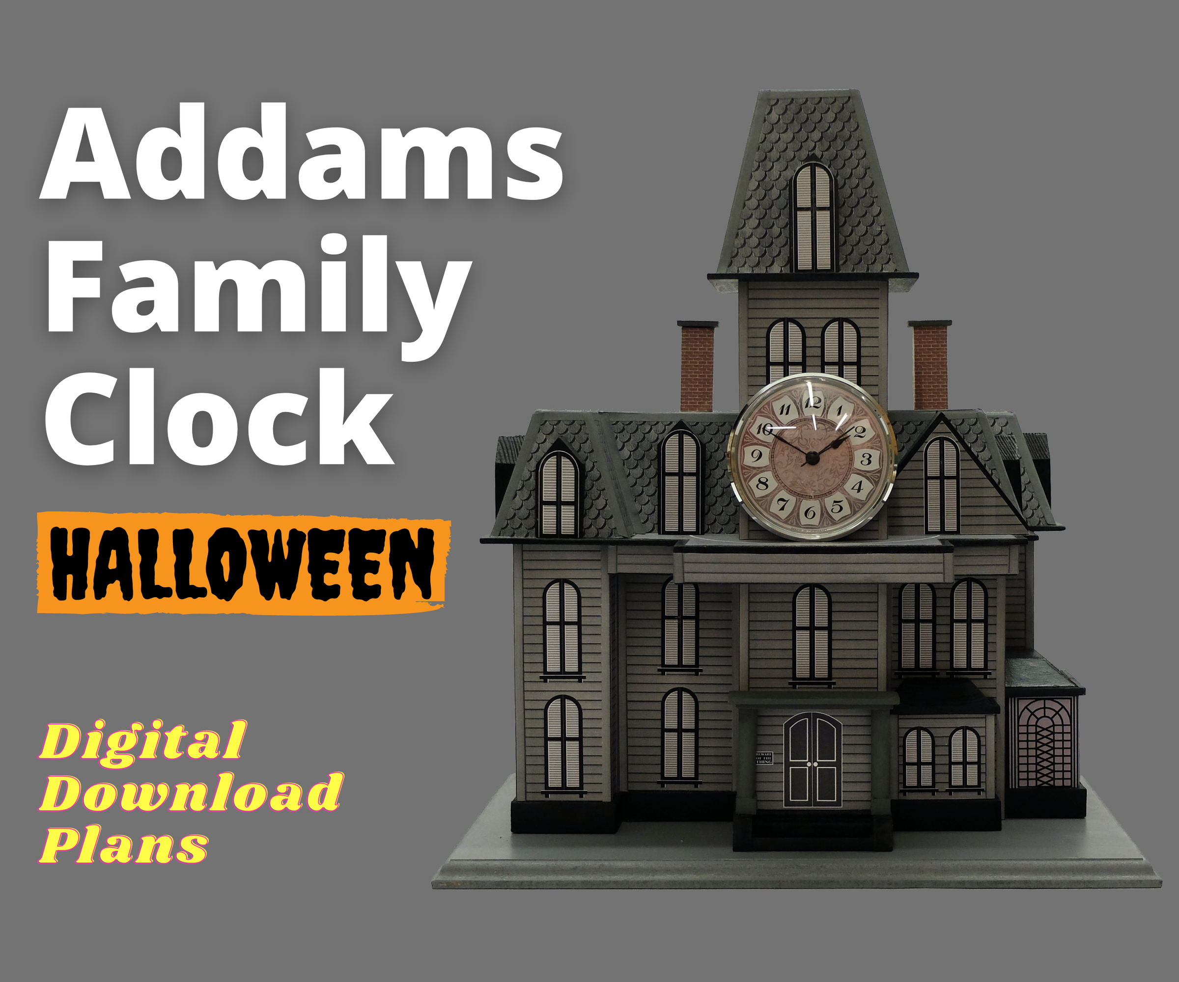

BATES MANSION CLOCK
Build yourself a Pyscho House Clock inspired by the Bates Mansion from the 1960 movie Psycho.
This clock is the perfect woodworking craft project and will look really great in your home or Halloween horror display. It's pretty easy to make using common workshop tools and basic woodworking skills.
PDF Instructions & Templates
The plans come as PDF files containing detailed instructions on how to cut and assemble the components of the clock. You also get full sized paper templates to help with the cutting out process and detailed A4 artwork to print out and apply to the outside surface of the clock.
You simply supply the wood, the glue and the clock movement. You can see from the photographs that very good results can be obtained with a little bit of time and effort.
