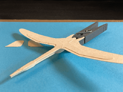

Step 2: Reinforcing the Main Piece
Use a glue stick to attach the neck reinforcement first, then the wing reinforcement, and lastly the head.
Step 3: Body
Cut a piece of paper clip 15 mm (for micro size) or 28 mm (for regular). Use a ruler to make creases and define the tabs of the two body pieces. The piece of paper clip will be embedded between these to pieces, at the nose. Apply a bead of liquid glue, of appropriate length, to the nose of one of the body pieces. Place the piece of paper clip. Wait about a minute, then apply a thin layer of glue to the other body piece and begin aligning and pressing the layers together, starting at the tail and working toward the nose.
Wait another minute, then use liquid glue to attach the body to the ventral side of the main piece. In addition to a thin layer of glue on the four tabs, a thin bead must be added along the spine of the body.
Step 4: Fins
Make creases to define the ruddervators on the two tail pieces. Apply a thin bead of liquid glue to the base of each. Attach them vertically and wait about 90 seconds for the glue to set up, then slowly angle each fin outward by 45 degrees.
Step 5: Wing Contour
Pinch along the leading edges of the wings to curl them down slightly. The curl should be greater at the wing roots and gradually fade to flat near the wing tips.
Starting at the aft elevators, on the trailing edges of the wings, pinch with your finger and thumb to curl the edges up by about ten degrees at the wing roots. Working out to half the distance to the tip, let the curl fade to flat. Past the midpoints, start to curl the trailing edges down a few degrees, and fade to flat again at the wing tips.
Use a ruler to define the creases of the wing roots. Raise each wing tip by about seven degrees above horizontal.
