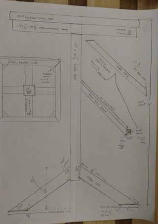

Stool SketchLet's break the stool apart from top to bottom. Each 15” round stool seat is 1" thick. Just below that will be a 10" square built out of 1" square tube. Encircling that 10" square will be some 1.5" x 1/8" thick flat bar (C=44.4288", but I'd cut 44 5/8") turned on edge. Four braces will run inward from the center of the sides of the 10" square. They will need to be cut to 3 1/4" because the stool post running vertical will be 1.5" square tube. Fastening the stool seat to the 10" square will require some gussets (small triangles) to be cut and (3/16") holes to be drilled in them. You can drill one or two holes per gusset. I prefer two holes but have used a single hole with good results. Back to the 1.5" square tube stool post running down 24 1/2" towards the stool feet (angled out 125 degrees from the vertical, or cut to 55 degrees themselves). If you add the 125 degrees to the 55 degree cut you'll find another mathlete formula for a straight line (adds up to 180). Alright so let’s get back to the stool feet. There are 4 stool feet per stool, one per side of the stool post. I only put two on the sketch so I could give extra measurements and angles. Each of the 1.5" square tube stool feet are 11 1/4" long with the 55 degree cut on one side and a 35 degree cut on the floor side (point to point, reference the image with the small square and the stool leg template I cut). The tip of that stool foot should sit 9 1/4" out from the 1.5" vertical stool post (see the image with my template stool foot and small square). Mathematically speaking I added in an extra 1/4" to the vertical stool post so it could hang down and leave you a good place to weld in case your cuts aren't quite perfect (see the image with the stool upside down). Now on the way down we skipped over the piece of 1" square tube that stabs off at a 45 degree angle that'll support the piece of 1" square tube used for a foot rest. The Foot Rests are really optional, but if you want them then cut a piece of 1" square tube that's 10" long on 45 degree angles (long to short, see the sketch on the right side of the stool). Then for the actual foot rest I'd cut a piece of 1" square tube that's 14" long with 45 degree angles on each end (long to long, see it in the bottom left side of my sketch). Those 45 degree cuts will need some small rectangles cut to cap the ends. You can use some thin sheet metal, a slice out of some 1" square tube, or even some of your 1.5" flat bar. Just trim them to fit, tack, and fully weld the seam when the time comes. The stool feet will also need caps cut. For them I recommend using 1.5" flat bar cut to 3" (It'll give you a slight lip to weld). That leaves us needing to preview my design for the table itself.

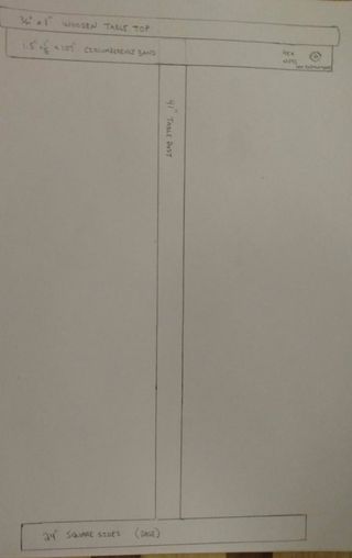

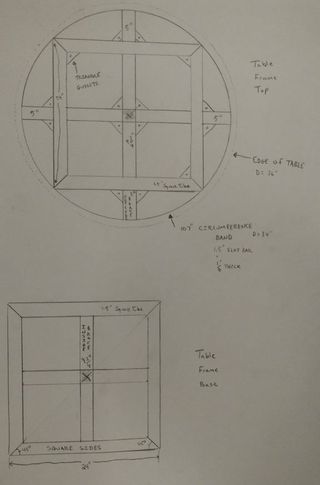

Table SketchWe'll again go top down but this time you'll need to look at the next sketch. We'll be using those formulas again so feel free to double check the measurements before you buy and cut material. For the 36" round top, we'll follow a similar frame structure. Instead of a 10" square built out of 1" square tube, we'll use a 24" square built out of 1.5" square tube. That will give us a hypotenuse or diameter of 33.9411" (~34" if you want to round). Plug that 34" diameter in to find our circumference for the encircling 1.5" x 1/8" flat bar and you'll see we need 106.629". I'd cut at least 107" and trim down because depending on your method for bending that large radius it may be short. Most of the images you'll see here are before I built my roller press for bending large radius rolls. Maybe I'll do another instructable for the press one day. So let’s get back to that band… Take a look at the sketch of the table top frame again. Table Frame PartsYou'll see I added in a few more pieces of 1.5" square tube in the middle of each side going out (instead of inward like on the stool seat). Those pieces are going to be 5" long (24" square + 5" brace + 5" brace = 34" diameter). You should also see the position of the gussets. I did not draw the one in the lower left corner though it does need installed. You can always add more gussets if you want. Running from the inside of the 24" square are more pieces of 1.5" square tube that are 9 3/4" long. Those will tie into the 41" vertical post for the table (again 1.5" square tube, see the bottom image in the sketch). If you don't know how to use a framing square or don't know the difference in plumb and level when using a level... Now would be a good time to learn. No one wants their stool to lean or their drink to spill. Alright so now that we've went over the design let’s add all those pieces up and figure out what you need to buy when you go shopping. Earlier I gave you a bunch of measurements during the design preview. Let's make a list of those parts and quantities you'll need to cut out so we can add them up to determine the shopping list.

Part No.QtyMaterialDimensionsCut DescriptionReference
SP-A(4)Wood15" diameter x 1" thick[none]{Round Stool Seat}
SP-B(4)Flat Bar1.5" wide x 1/8" thick x 44 5/8" long[cut square on 90 degrees]{Circumference Band}
SP-C(16)Square Tube1" wide x .065" wall thickness x 10" long[cut long to long on 45 degrees]{10" Square Sides}
SP-DI(16)Square Tube1" wide x .065" wall thickness x 3 1/4" long[cut square on 90 degrees]{Inside Braces}
SP-E(4)Square Tube1.5" wide x .065" wall thickness x 24 1/2" long[cut square on 90 degrees]{Stool Posts}
SP-F(16)Square Tube1.5" wide x .065" wall thickness x 11 1/4" long[35 degrees on floor side, 55 degrees on stool post side, cut long to long]{Stool Legs}
SP-G(16)Flat Bar1.5" wide x 1/8" thick x 3" long[cut square on 90 degrees]{Stool Feet Caps}
SP-H(16)Flat Bar2 sides are 1.5" wide x 1/8" thick[cut on 45 degrees, with 3/16" hole center drilled]{Triangular Gussets}
LS-A(16)Metal#8 x 3/4" longBuildex Teks #21504{Lath Screws}
Stool Options (Qty of 4 stools)
SP-I(4)Square Tube1" wide x .065" wall thickness x 10" long[45 degree cuts, long to short]{Foot Rest Brace}
SP-J(4)Square Tube1" wide x .065" wall thickness x 14" long[45 degree cuts, long to long]{Foot Rest}
SP-K(8)Flat Bar1 3/8" long x 1" wide x 1/8" thick[cut square on 90 degrees]{Foot Rest Cap}
HN-A(48)Metal*5/8" or 3/4"[none]{Hex Nuts}
Table Parts
TP-A(1)Wood36" diameter x 1" thick[none]{Round Table Top}
TP-B(1)Flat Bar1.5" wide x 1/8" thick x 107" long[cut square on 90 degrees]{Circumference Band}
TP-C(8)Square Tube1.5" wide x .065" wall thickness x 24" long[45 degree cuts, long to long]{24" Square Sides}
TP-DI(8)Square Tube1.5" wide x .065" wall thickness x 9 3/4" long[cut square on 90 degrees]{Inside Braces}
TP-DO(4)Square Tube1.5" wide x .065" wall thickness x 5" long[cut square on 90 degrees]{Outside Braces}
TP-E(1)Square Tube1.5" wide x .065" wall thickness x 41" long[cut square on 90 degrees]{Table Post}
TP-H(16)Flat Bar2 sides are 1.5" wide x 1/8" thick[cut on 45 degrees, with 3/16" hole center drilled]{Triangular Gussets}
Table Options
HN-A(24)Metal*5/8" or 3/4"[none]{Hex Nuts}

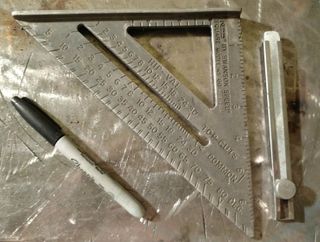

Mark them using a soap stone or felt tip pen using a square to ensure the 90 degree cuts. It’s always a good idea to check your saw to ensure it’s square/perpendicular before you start. If you’re very meticulous you can use a dial indicator to really get super accurate results. There are several videos available to learn how.
[2.] Cut the 1.5" square tube pieces for the squares in the table [(8) TP-C, for top and base]
I recommend you mark these using a speed square. If you’ll leave/account for an extra blade thickness of space and then line them up with one right side up the next upside down (causing you to save material) and cut every other one then you’ll save reset up on your abrasive chop saw. You’ll have to mark both sides of the material though because the every other one will need you to flip the piece twice to save a saw setup change. So it’s a trade-off decision in time spent marking the other side or time setting up the saw. Here’s an example using text to illustrate the layout on a sample 10 foot stick of material [=/=======\\=======//=======\\=======//=======\====]. Notice the “\” or “/” is a 45 degree cut and the “\\” or “//” is a 45 degree cut with the extra blade thickness added in.

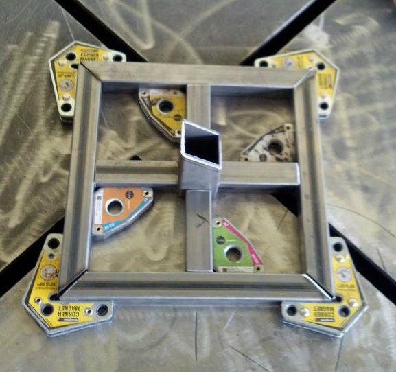

Before you start assembling the squares do a couple quick checks on your work surface. It's ground zero for either a great product or the failure. The point is make sure it's not just "flat" but level front to back and left to right.
Dry Fit – Before you just go straight to welding take a minute to check how the pieces fit/assemble together.
Tack Weld – After you achieve a good dry fit, you’ll need to be ready to square/plumb/level and tack weld the pieces. If you aren’t already a skilled welder, perhaps visit Jody over at Welding Tip and Tricks to learn some pointers.
Seam Weld –This is basically finishing the weld around the seam or joint

Step 10: Building the "Squares"
Locate your trusty square and fit up the 4 sides that'll make up either square. You can see where I've clamped a mostly assembled 24" square to my welding bench. On the smaller square there's another image of me using magnets to hold the sides square. I really love those MST327 corner magnets on the outside. If the sides are a nice tight fit and measure out appropriately (24" on the Table's 1.5" square tube; 10" on the Stool's 1" square tube) I suggest a couple light tack welds while holding them together with your square firmly pressed in the corner or in a clamp like I did. I own a couple different styles of clamps and they're well worth the investment. Another option would be a welder's magnet. I typically tack two pieces together to form an "L" (try and keep your tacks small and on the same side so as to prevent a tack weld from lifting the work piece off the table and causing a misalignment), then the next two. Then those two "L" pieces I'll do the same thing as before (holding a speed square tight in the corner) to complete the full 10" (stool) or 24" (table) square. Once you've done all the squares for the table and stools you'll need to start tacking in the "braces" which we'll cover in the next step.
Step 11: Add in the "Braces"
The braces on the stools are really short. I suggest placing a scrap piece of 1.5" square tube in the center of the 10" square to use to align the 3 1/4" pieces (see the image earlier with those corner magnets).square tube inside the braces Sometimes you may need to use a flap disc and grind a little off one end to get a proper fit. Then essentially line the pieces up with a small square (you can probably eye ball these to center on the 1.5" scarp piece, just don't tack the brace to the 1.5" scrap). I don't have a small enough square, thus the other set of colorful MS346AK mini magnets in the image earlier in Step 10. I'll typically tack three sides of the 3 1/4" piece (just not underneath because that'll be the side that goes against the wood top; we want it flush with the table top). Once you've got all four braces tacked on three sides you can start welding the seams (minus the scrap piece you used to align it with). Be mindful of the pieces drawing towards the welded area. Clamping will help prevent it from pulling so much. Let me emphasize that again. After you've tacked the three sides of those braces on all 4 stools, go ahead and weld the seams (except the side that'll be against the table top). The idea is to leave that part to finish in the end. We don't want a weld to raise your work piece off the table and cause it to be crooked. Move onto to the table squares and their braces.
I'd do the inside braces like the stools, then move to the four 5" braces that'll stab out to the circumference band. Every time you go to flip your welding hood down, pause and double check that you're still following the sketch and that what you are about to tack or weld is squared up nicely. You can see several images of the table top frame. On that build I did the gussets in a different order. Not all of the gussets used in this design are in the image. I recommend you wait until we get to that step in the build sequence. After you have the braces welded in place it'll be time to move on from squares to circles... Now it's time to see if you can fit a square in a circle.
