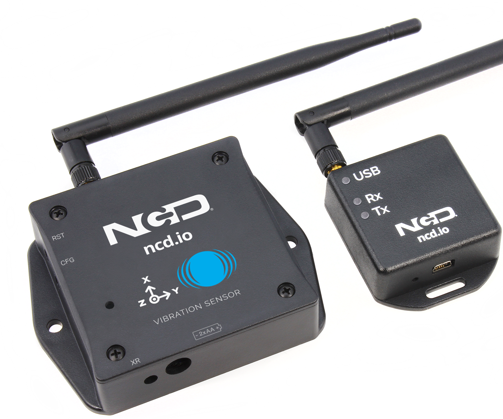

Step 2: Wireless Pressure and Temperature Sensors
Features
- Industrial Grade Sensor Long Range Wireless Pressure Temperature Sensor
- Operating Range 0 to 14000 mbar -40° to +85°C (-40° to 185°F)
- Configurable Internal Calculation Pressure Resolution 0.012 to 0.065 mbar
- Configurable Internal Calculation Temperature Resolution 0.002 to 0.012 °C
- Accuracy ±2.5 mbar, ±2 °C
- Absolute Pressure, Relative Pressure and Relative Altitude Change outputs
- 2 Mile Line-of-Sight Range with On-Board Antenna
- Superior LOS Range of up to 28 Miles with High-Gain Antennas
- Interface to Raspberry Pi, Microsoft® Azure®, Arduino and More
- Wireless Mesh Networking using DigiMesh®
