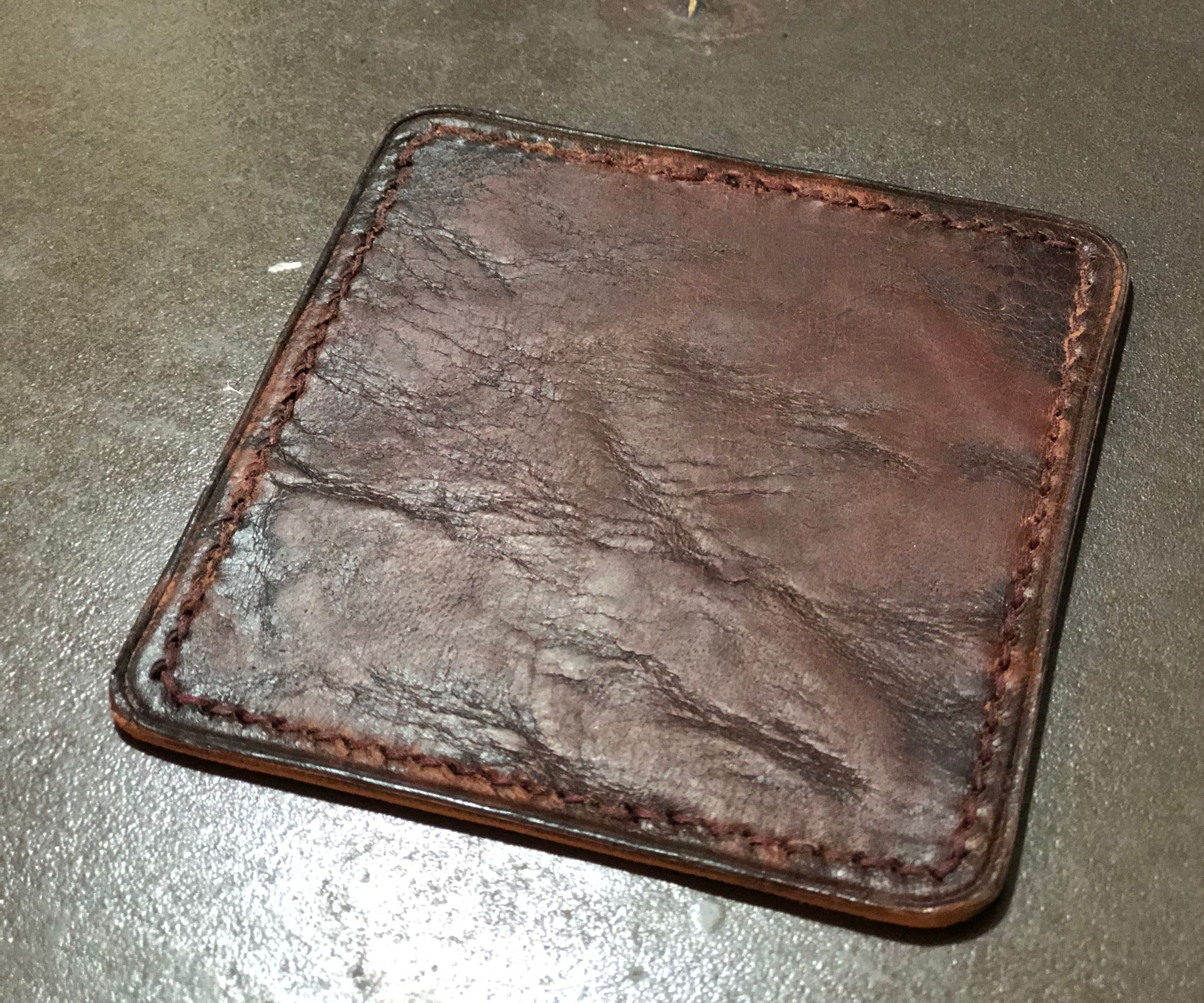

About 2 years ago I was sick of traditional card holders with a limited amount of pockets. I wanted a smaller/slimmer wallet but also a wallet that did not restrict the amount of cards I could hold. After much browsing I came across Distil Union's Micro Wallet and I loved the concept. The only thing I did not like was how the elastic band would be on the outside and double as a cash pocket. So for the longest time I did not have a cash pocket, until I came across the Anson Calder Card Wallet. I really liked the design of having a diagonal slit for the cash pocket. Taking the two concepts I made the wallet you see now. This is the 5th time I have made the pull tab wallet. Each time I make this wallet I try something different so I can learn from each project.
Notes
So I have made this wallet so many times that I know it pretty well but I realized as I was writing the steps, that steps 6 and 18 are especially confusing so please don't hesitate to ask questions if anything is confusing! Better to ask questions than have 8 hours of work go down the drain...

Step 13: Saddle Stitch
- Again I will not go into detail on how to saddle stitch, but the result that I am going for is the slant you see in each stitch
- Just take your time and make sure each stitch looks the same
- You don't have to pull too tightly, just enough so there isn't slack
- End your stitch on the flesh side and singe the thread
Step 14: Doing the Edge
- My process starts with beveling the edge
- Sanding the edge at an angle
- Applying Edge Kote
- Burnishing with burnisher attached to Dremel
- Repeat until you are satisfied with how the edge looks
