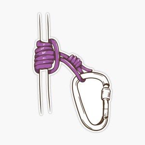

Step 1: Prusik Knot
A prusik knot is a type of friction knot that slides on another rope freely but under tension locks itself onto the rope in place. It is a climbing knot relied upon to prevent climbers falling. In this case the prusik knot will be used to customize the length of the the mainline for the pulley system by creating a lock at the desired length.
With your shorter length of thinner diameter rope tie a prusik knot loop onto the main line (tension the main line to make this easier), you may want to cut and cauterise the ends with a lighter and retie it to create a smaller loop if it's too long.
The rope for the prusik should be slightly smaller in diameter to the main line so that it grips as intended. It’s vital to test your prusik knot prior to loading; and to load in increments to ensure theres no slippage under tension. I found that i needed eight coils but you may only need six if the difference in diameter between the two ropes is great enough and if the friction is adequate.
