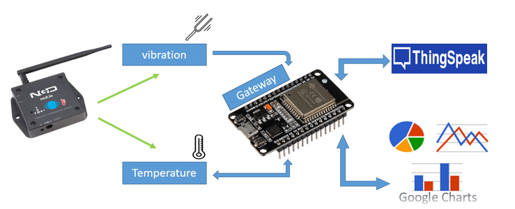

In this instructable we will be using Google Charts to visualize the sensor data. It provides us many options like line charts, Area Charts, pi charts, Histogram, multi value charts etc. So, here we will be learning about the following:

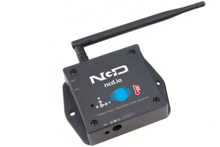

  • Wireless Vibration and Temperature Sensors.
  • Hardware Setup.
  • Gathering the data using Wireless gateway device.
  • Publishing the sensor data to ThingSpeak.
  • Importing the recent data from ThingSpeak..
  • Visualizing the data in Google Charts .
  • Loading the charts in the webpage

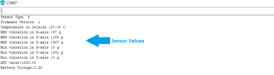

Step 3: Getting the Vibration Sensor Values

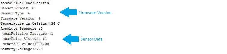

The vibration values, that we are getting from the sensors are in milis. These consists of the following values.
  • RMS value- root mean square values along all three axes.The peak to peak value can be calculated as
peak to peak value = RMS value/0.707
  • Min value- Minimum value along all three axes
  • Max values- peak to peak value along all three axes.The RMS value can be calculated using this formula
RMS value = peak to peak value x 0.707

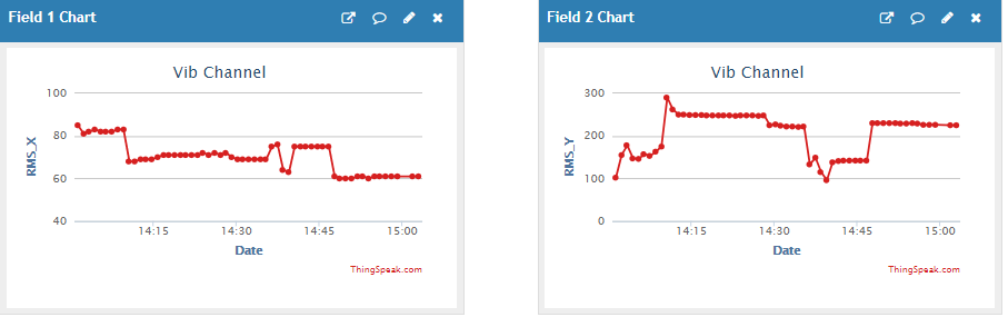

In the graph mentioned in next step we can see that we had some irregular vibration. But these vibrations were under the safe criteria and were not of any concern. The vibrations were usder o.75g. If in case subjected to faulty motor with high rotor eccentricity can show some irregular vibrations.

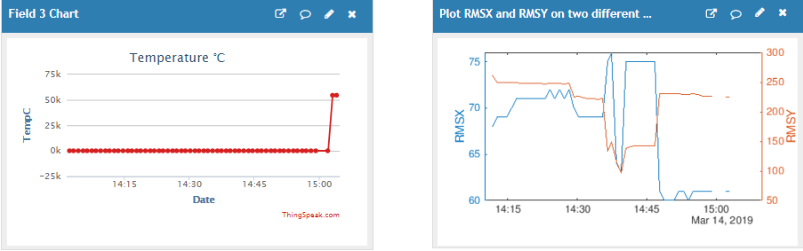

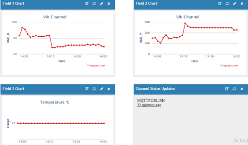

Step 5: Visualizing the Sensor Data on ThingSpeak

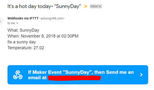

We are using IFTTT applets to give real-time weather report Email notification to the user. For more on IFTTT setup you can go through this blog. So, We have implemented it through ThingSpeak. We are sending an Email Notification to the user whenever the change in Temperature occurs in a machine. It will trigger an email notification “What a beautiful day”. Every day at around 10:00 am (IST) we will be getting an email notification
