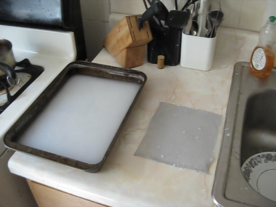

Step 4: Pour the Pulp Into a Tub
Pour the pulp into a 2 – 3 inch deep pan or tub. Combine with more water until it’s the consistency of soup.
Step 5: Dip Your Screen Into the Paper
Dip your screen into the paper pulp mixture.

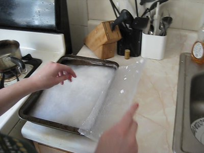

Flip the screen onto a counter (or cookie dough sheet for mobility) paper-side-down.
Pat dry with a towel. Remove as much water as possible.

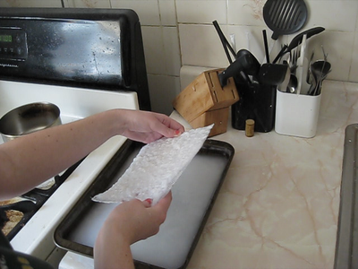

Step 7: Peel Off Screen
Peel back the screen. (You now have a piece of paper!)
