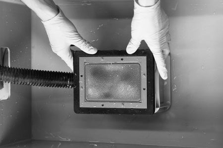

Step 1: Assembly and Setup
- The Eurobox is modified with a side drilling to connect the vacuum cleaner hose.
- The workshop vacuum is set to wet vacuum mode.
- The tool frame is 3D-printed (ideally from PETG with robust print settings) and assembled from two halves.
- The funnel component is also 3D-printed, ideally from PETG.
- The mold set is designed in CAD to achieve the desired shape. It is then 3D-printed in PETG with specially adjusted print settings to create the required surface quality. Both halves of the mold are mounted in their respective tool frames.

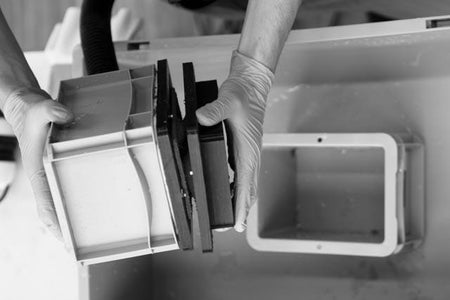

- The vacuum cleaner is connected to the Eurobox. The mold (mounted in its frame) is placed on top of the box, and the funnel is set on top of the frame.

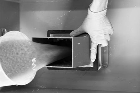

- With the vacuum switched on, a measured amount of pulp is poured into the funnel. The water is drawn through the mold surface, and the fibers remain behind.

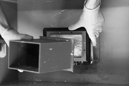

- Once the pulp has been deposited, the funnel is removed. Then press the other tooling side onto the pulp, to squeeze the water out.

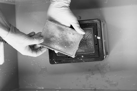

- The molded part can be carefully taken out after some initial drying and left to dry either in the sun or in an oven at the lowest setting.

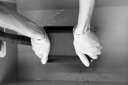

Step 3: Slicer Settings for the Tooling
Here you can see the effect of the chosen infill pattern on the molded surface. If the pattern becomes too fine, the part tends to stick, if the pattern is large, you get a fuzzy surface, make it even larger and you get holes in your part.
You can also use an offset version of the part as a modifier in your slicer. this allows you to have a very large and open surface pattern, but a finer pattern below this this layer, preventing holes that would otherwise form. this technique was used with the archimedes curve, to give it a supporting mesh beneath. (have a look at the provided 3mf. file for clarification)
