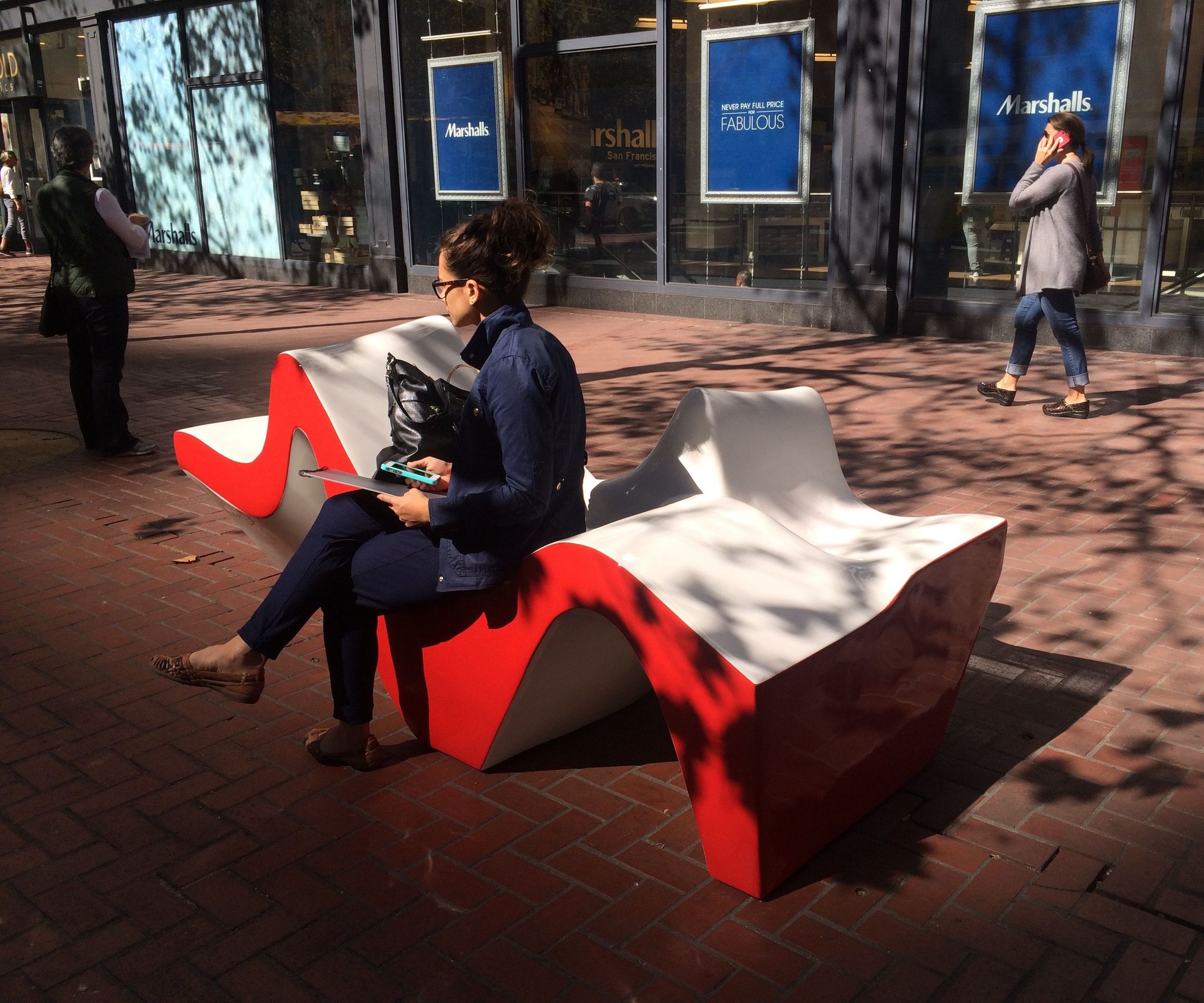

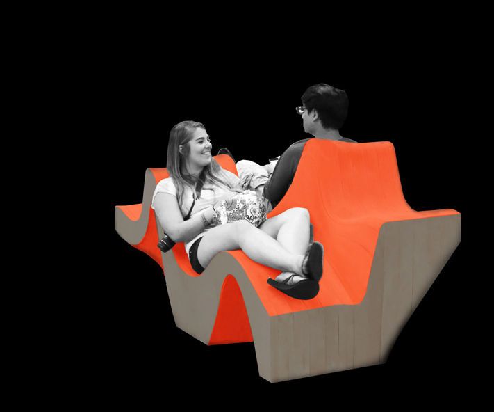

I chose to use 3/4 inch ultra light medium-density fiberboard (uldf) because it is soft, easy to cut and relatively light-weight. In the future I will choose to use exterior grade mdf so I don’t have to worry when leaving it outside. With this in mind, and previous experience which proved that laminating 4 4’x8’ sheets is too heavy to lift onto the CNC bed, I decided to laminate the sheets in 3-ply sets. So I sliced the model in 2.25” (3 x 3/4”) increments. I decided the two elevation pieces (because they are solid rather than hollow) should only be made of 1-ply material so for these two edges I sliced the model by 3/4”.
Alignment and Preparation of "Ribs":
Once the model is sliced it is time to lay out all the pieces. It is imperative that from the midpoint on the pieces are all rotated so the sloped surfaces are all facing the same direction. This is important because the CNC can only cut slopes in one direction, it cannot undercut. It is also very important that these slices are rotated to get the slope on the right side, rather than mirroring the pieces which will result in backwards, unusable pieces.
With a fully sealed perimeter for each “rib” member I offset this curve inward to create a 1.5” thickness. This allows the interior to be hollow and will significantly cut down the weight. In the first iteration I used a 3” thickness and the chair wound up far too heavy. Because it is fully solid, and gains stability from this solidity and overall mass, 1.5” is a good thickness, not too thin. It still was somewhat heavy so 1” may suffice, but may not guarantee sufficient gluing surface, which is the main structural source for this piece.

Once all the pieces are cut you can begin organizing them in numerical order. It is helpful to lay out the wood on bricks or blocks so that you can clamp each set of layers while they are drying from the glue. Wood glue tends to expand quite a bit, so using as many clamps as possible and clamping right away is ideal. The wood glue takes 24 hours to dry. This process took me about a week.

I didn’t sand the pieces from the roughing path grooves because these grooves allow the Bondo to stick to the MDF more easily. Apply Bondo to all sloped surfaces and sand until smooth. It took me a total of 7 tubs of Bondo.
