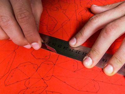

Step 3: Assembling the Heart
The cutting and gluing part is the ultimate test of your patience, persistence and mental breakdown threshold. I made two of these paper hearts. If anyone wonders why - the first parts I printed was of a non-inverted model and since I wanted to keep things possibly anatomically correct - left being right doesn't sound like that at all. I noticed the non-inverted thing after cutting out all the parts and figured I'll just glue it and see what else goes wrong so I can make the next one properly. Now this was actually a good idea, but I don't suggest that unless you have a lot of time on your hands. Learning from my mistakes should be enough.
As for gluing - I started with regular paper glue stick which sucked, then tried diluted PVA (around 2:1 or 3:1 glue:water) my friend suggested which actually worked somewhat well in most cases, but in the end I found using a very thin clear double-sided tape a nice and fast way to assemble it despite the fact that it's visible in some places (due to unattentiveness mainly, so can be avoided) and maybe the fact that it allows some movement (stretching), so you will have some of those little holes in corners where the paper wasn't aligned perfectly (I believe this is also avoidable). It's possible to somewhat fix it by supergluing those corners after it's assembled, like I did, although I'd suggest fixing these spots as you glue a smaller part of the heart together, due to easier access to the spot. Use superglue responsibly, because it's fairly visible when dried and you don't want some random blots on the visible side of the heart. I first applied a tiny amount to the wire of a resistor I found nearby and then used that wire for high precision application on the model. See pictures.

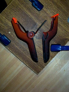

Würth polymer glue for gluing the steel sheet on top of wood seemed like a good idea, which turned out to not be the right one for the job. This glue is otherwise amazing, but does not spread easily, nor does it have a working time long enough for this area, so choose wisely. The second mistake was that after I noticed the steel sheet moving while clamped I took the clamps off and tried repositioning and clamping differently and due to that also using more than one piece of MDF for clamping. Ended up with it out of place anyway and had to sand down later, so some kind of straight corner support while gluing is recommended as well as more than 3 serious clamps and some crappy ones would be good. These mistakes led to me eventually deciding to make an entirely new base for the lamp using almost the same design and learning from the mistakes.
The second take was done using easier spreading contact adhesive without the hopes to align straight edges. I also cut the steel sheet even bigger, around 240x240mm to make cutting easier. After I was sure that the glue has done its job I went for the cuts on two remaining edges. Nothing magical here, just place a straight edge to guide the jigsaw and go for it. If one of the sides of the jigsaw's bottom goes off the steel sheet while cutting, it's a good idea to put the same thickness piece of something under it so the blade stays maximally straight. It is also a good idea to clamp something you can move along the cut line in front of saw to prevent lift-off of the steel sheet edge (see pictures). No need for that if both sides of the jigsaw shoe sit on the same sheet you're cutting and you've spread your glue well.
After everything was cut I sanded the sides and the bottom with an eccentric sander (80 grit pad) somewhat smooth and checked for flaws in gluing and similar. Found some of those and fixed them with super glue and eventually finished sanding. The thin steel sheet on top really helps with going through sanding pads quickly, so glue responsibly, you will have less of that then.
