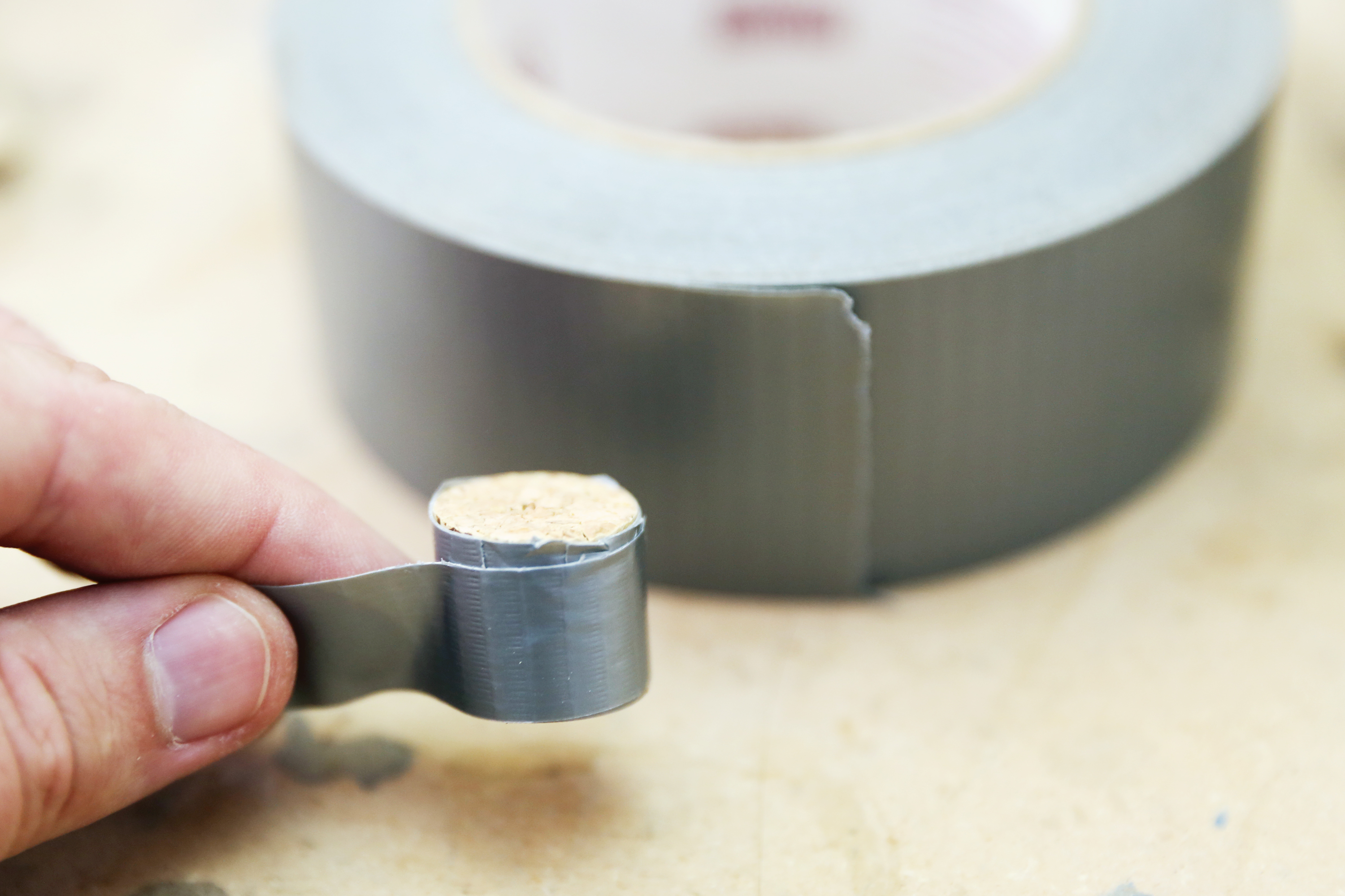

Take a wine cork and stick it into the soda bottle's opening to test and make sure that it fits in snugly. The seal has to be tight, so if your cork doesn't fit then look for a larger cork - or you can wrap the cork with tape to slightly increase the diameter.

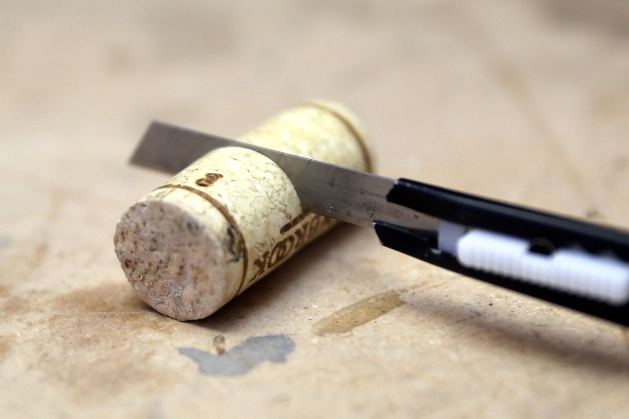

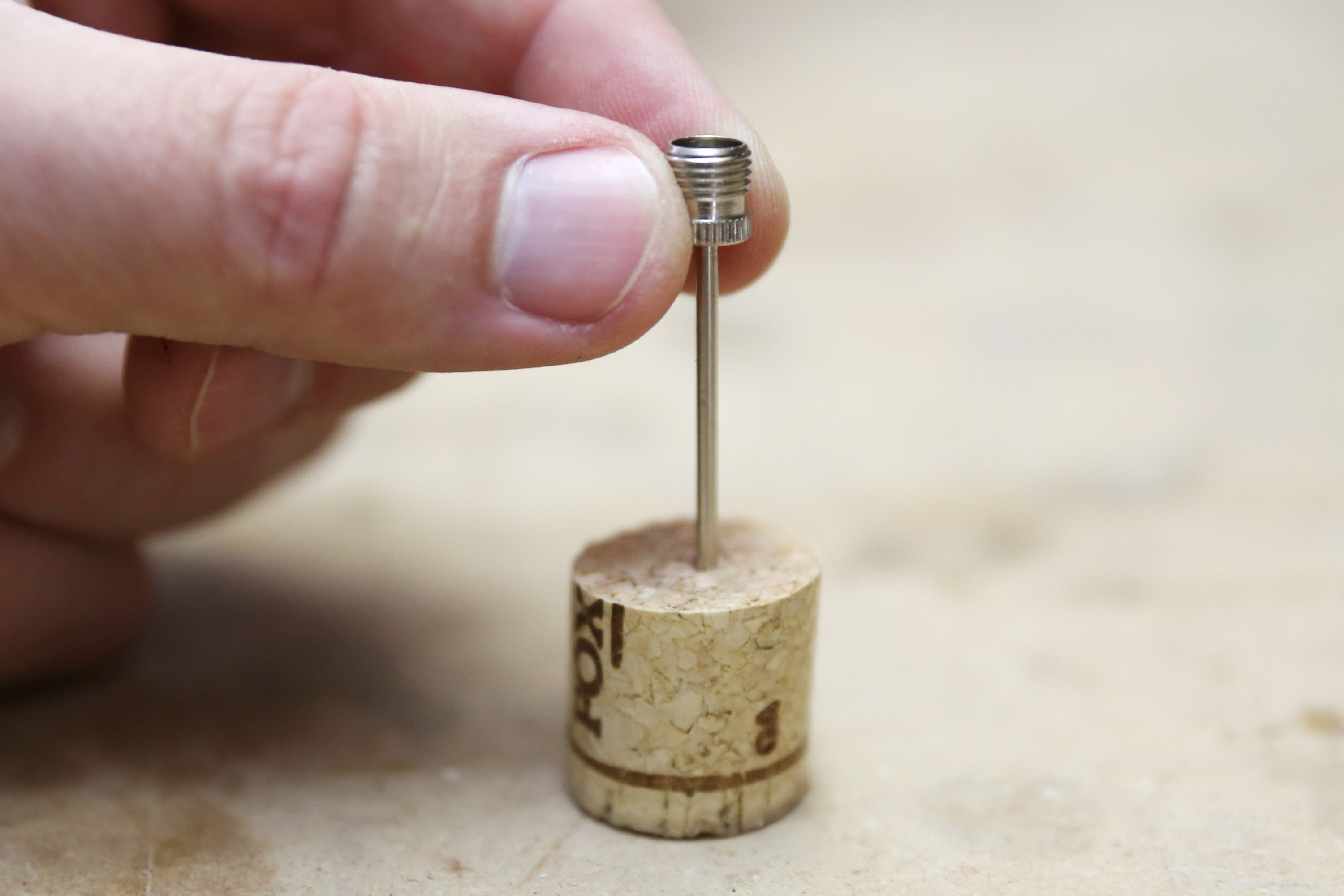

Remove the cork from the bottle and use a sharp knife to cut the cork short enough so the Schrader (bike pump) needle is longer than the cork. If you look closely at the top of the inflation needle you can see a small opening that needs to stay exposed.
Step 3: Drill Into Cork
Using a drill bit that is slightly smaller than the inflation needle, drill into the center of the cork all the way through. If you don't have a drill you can punch through the cork with an awl or a nail. The important thing is that the drilled hole is smaller than the Schrader needle.
Push the Shrader needle through the drilled opening to check that needle eye is completely unobstructed when inserted into the cork.

If your cork is slightly smaller in diameter than the bottle opening you can wrap it with tape to make the diameter larger.

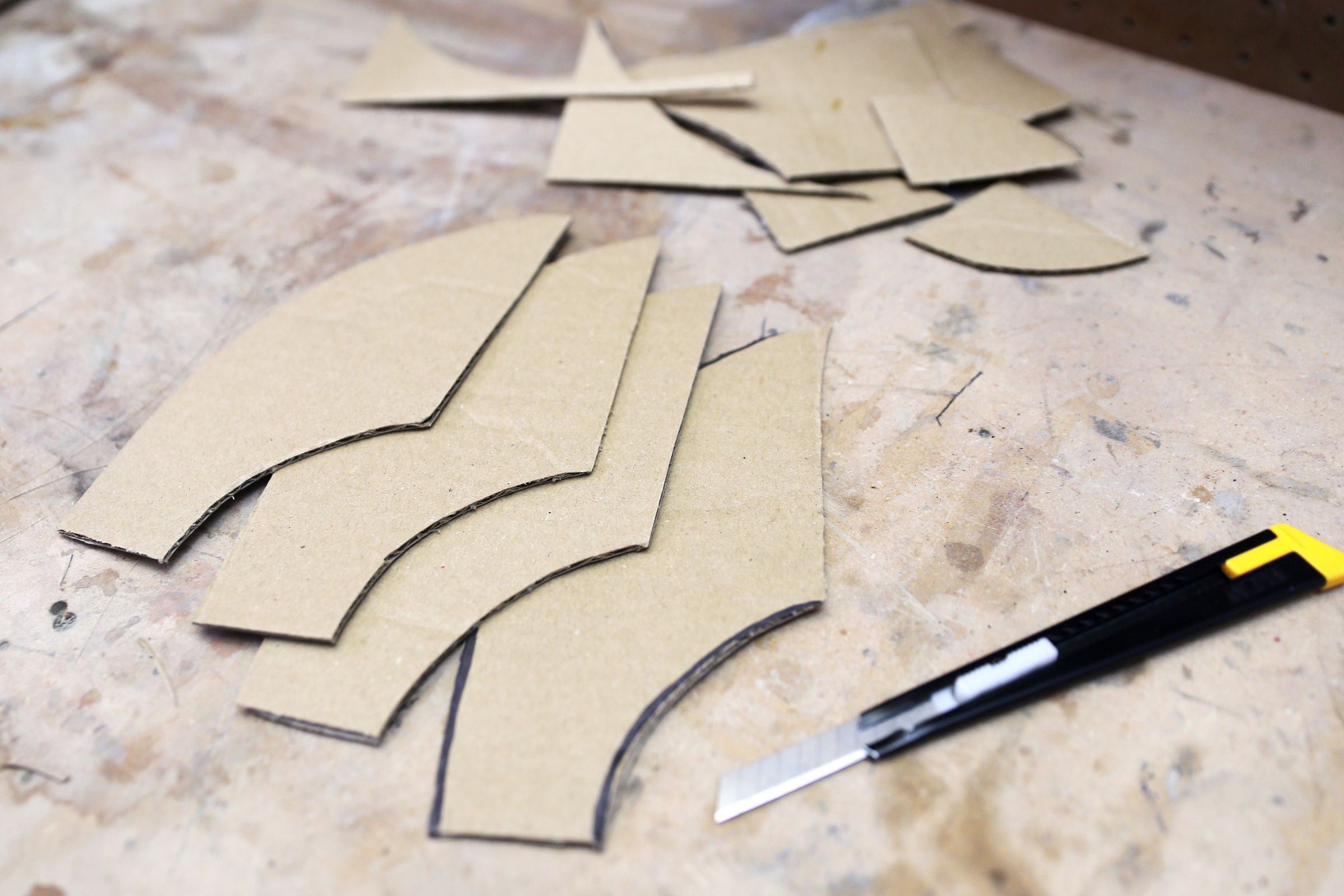

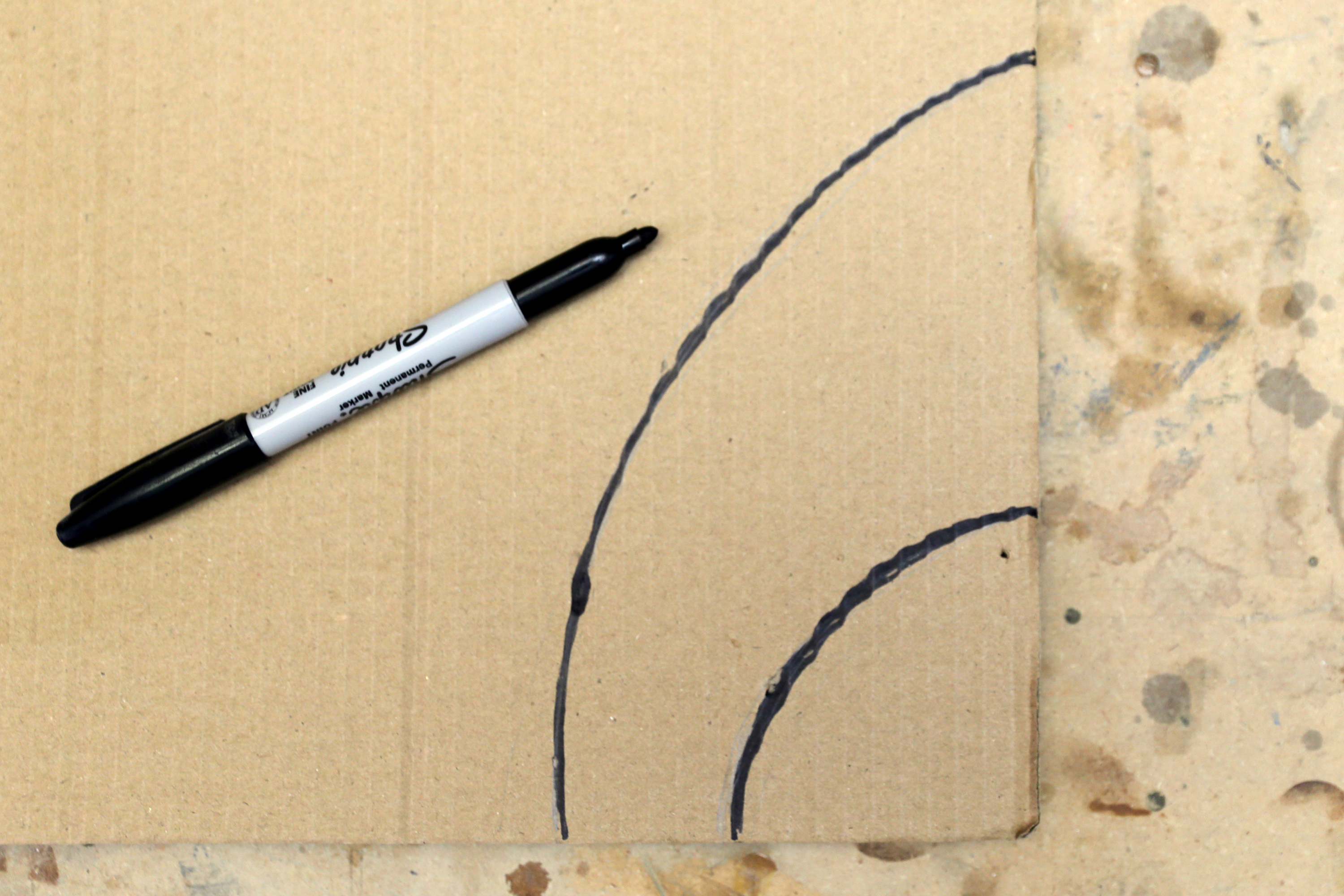

Rocket fins can be made of almost any rigid material and take almost any shape you like; I made these fins out of an old cardboard box. I wanted these rocket fins to be large and rigid enough to hold the rocket up off the ground, allowing enough room for the bike pump valve while keeping the rocket perpendicular to the launch pad (the ground).

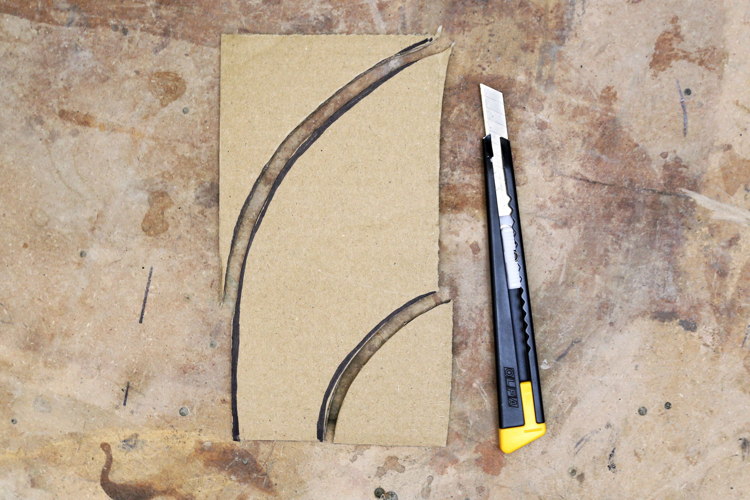

Once I was happy with the sizing and shape, I first cut the rocket fin out using a sharp hobby knife.
Then, repeated the same process for a few more fins. Your rocket can have as many fins as you like, but I recommend 3-4 fins (a good compromise between weight and stability).

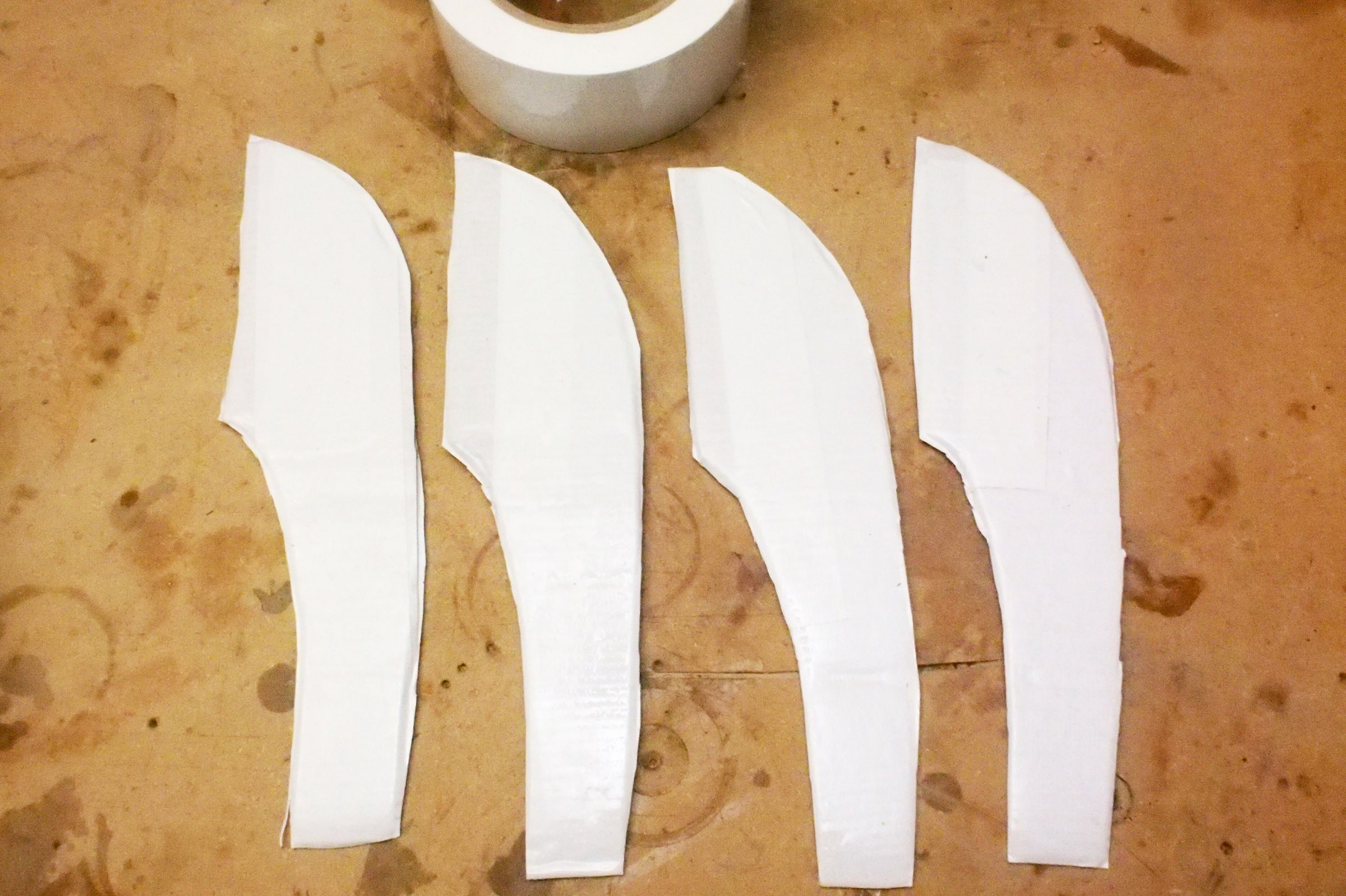

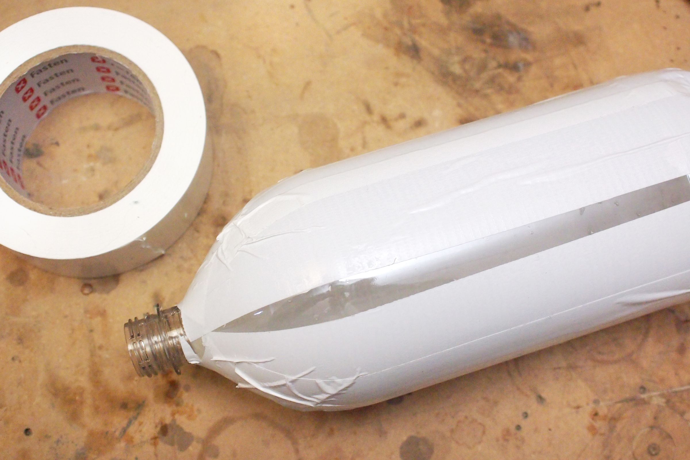

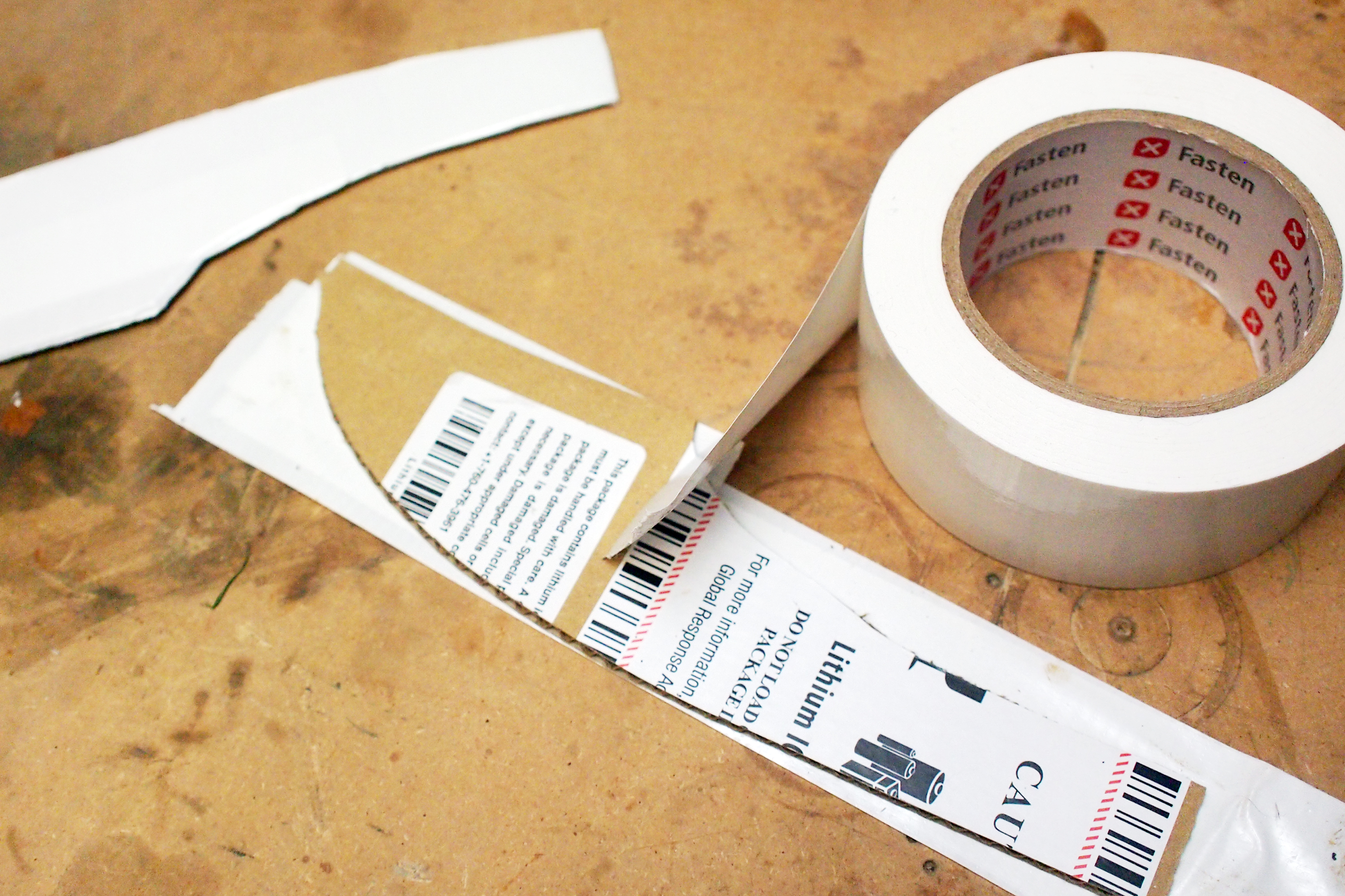

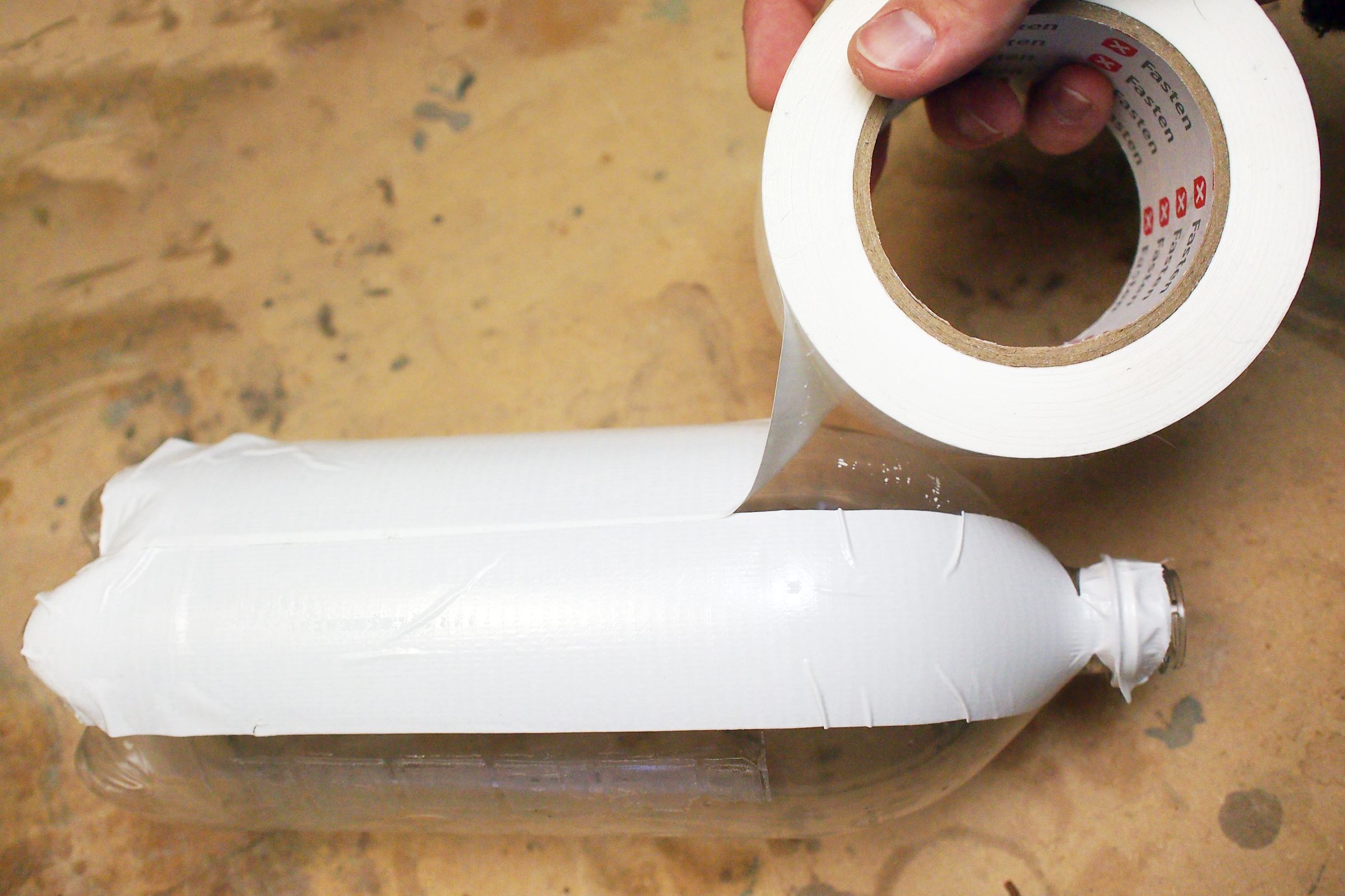

Borrowing from NASA's space program I decided on a white covering for my rocket. I used white duct tape, since it has the added benefit of being able to secure the fins together while covering them, but paint could also work.
When covering the bottle I deliberately left a section running the length of the bottle uncovered, allowing a window into the bottle so I can see how much water ballast to add later.
The fins were covered in the same manner and reattached to the body.

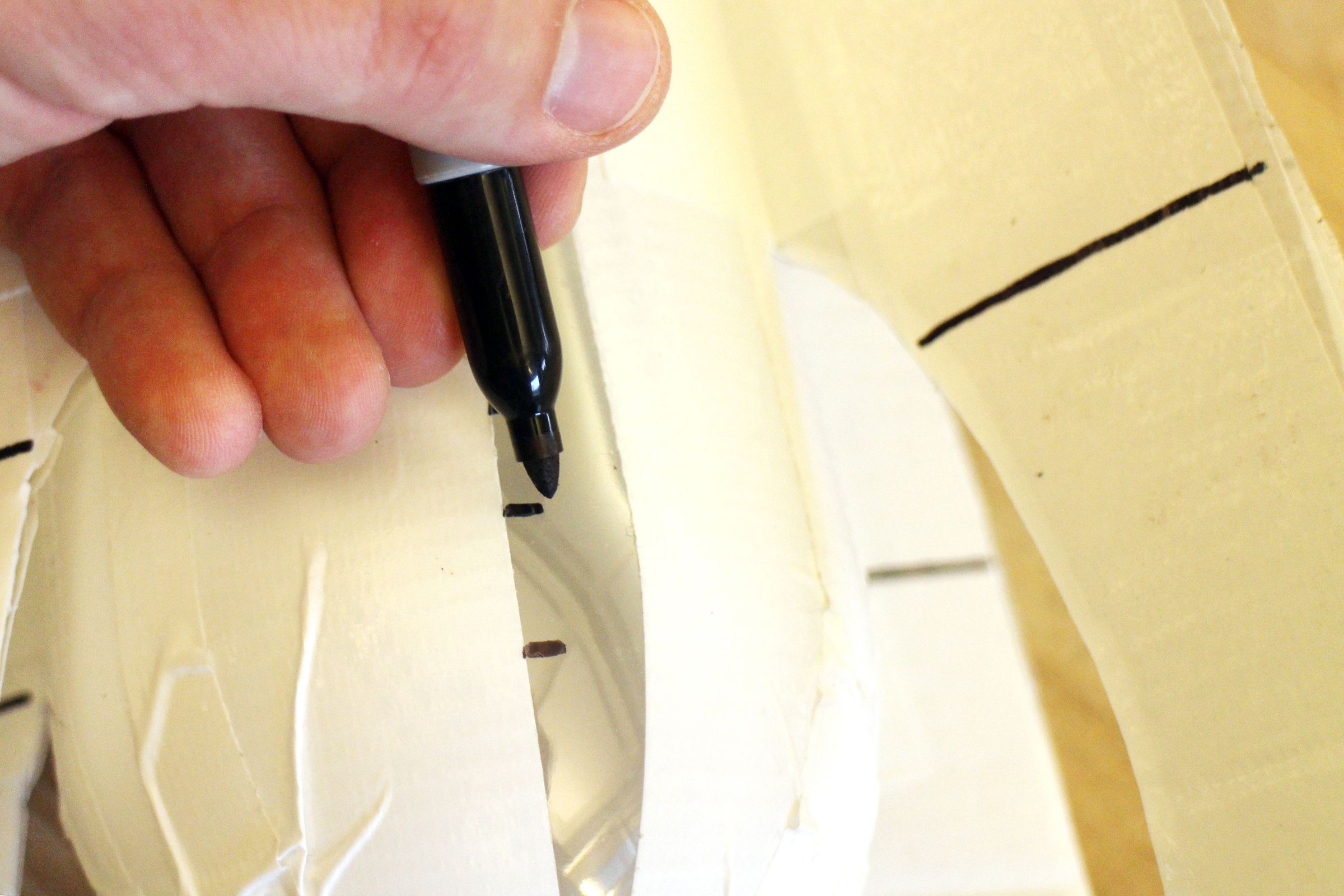

While I was at it, I used the uncovered window I left to be my water gauge, applying incremental markings with a permanent marker. Your rocket is all ready to go! Head outside with your rocket, bike pump, some water, and get ready to launch!

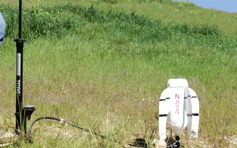

Before blasting off you're going to want to source an area outside, since it's going to be a messy launch. Find an open location away from people, power lines, buildings, and trees, and make sure you're able to get the area wet (like a field or the driveway).
Invert the rocket and fill the bottle about 1/5th full of water. The water in the rocket is the reaction mass that will help launch it high into the air.
To prevent any water loss, it's a good idea to insert the inflation needle of the pump into the cork first and then install the inflation needle into the bike pump before plugging the bottle opening with the cork. This ensures a very snug fit before upending the bottle.
Turn the rocket right side up and place on a level surface in preparation for launch.

When you're ready to launch, start pumping the bike pump to build up pressure inside the bottle. You'll hear the bottle bubble and fill with air. With enough pumps, the pressure inside the bottle will build to a point where it overcomes the friction holding the cork in place and jettison the cork and inflation needle, sending the rocket skyward! You may need to hunt for the cork and needle if it becomes detached from the bike pump after launch.
