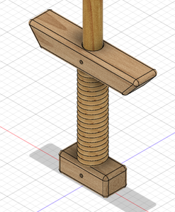

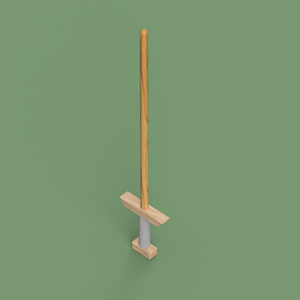

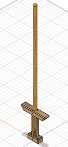

Step 2: Design the Sword
While deciding on what to make with these materials I tried multiple designs in fusion 360 and decided on this prop sword. All dimensions for cuts were based off of this model.

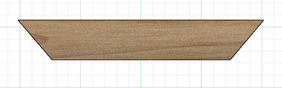

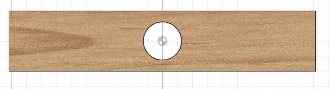

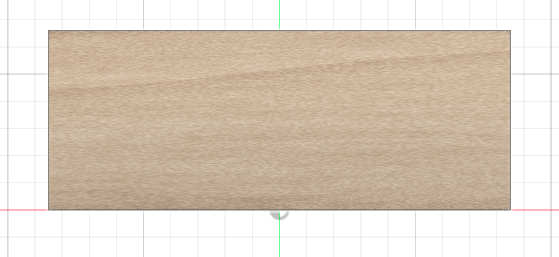

Step 3: Cut the Cross Guard and Pommel
From the scrap wood cut one 8" piece for the cross guard and one 3-1/3" piece for the pommel. Take the cross guard and cut a 40 degree cut off of ether end as shown in the drawing attached.

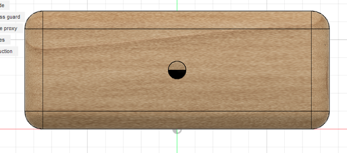

Step 4: Drill Holes for the Blade
Into the top of the cross guard drill a 1" hole in the very center all the way through. Do the same for the pommel but only drill about 3/4 the way into the piece so the blade cannot go all the way through. Do your best to have these hole be as straight as possible to ensure that your blade is perpendicular to the cross guard and pommel.
Step 5: Round the Edges
To smoothen the edges and give it a weathered look I took a utility knife and cut every edge on the pommel and the cross guard. Do this until there is a rough 2mm chamfer on ever edge. Then with sandpaper sand down every face and round the edges further. I went from 60 to 100 grit.

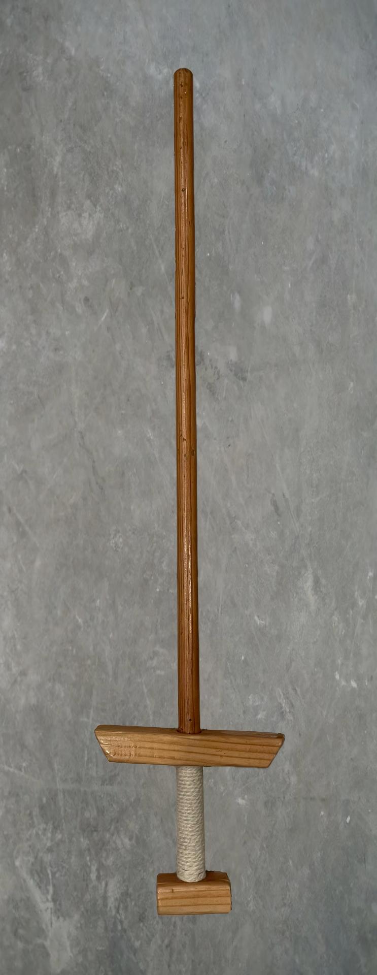

Step 10: Final Product

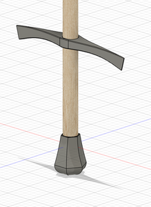

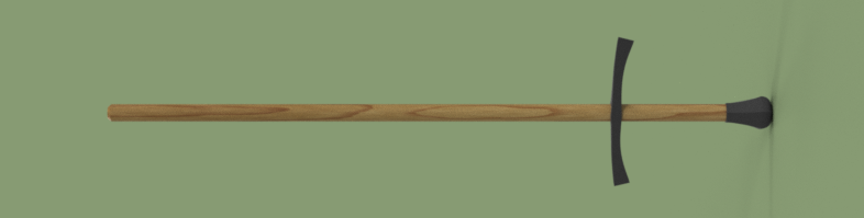

Step 11: Alternative Cross Guards & Pommels
Given the design of the sword, letting you remove the cross guard and pommel while keeping the handle in the same position, if you were to want to make different sets of hardware for this sword, you would be able to switch them out quite quickly or even make it with a new design from the beginning. One way is to 3D print new sets of cross guards and pommels that it different time periods and aesthetics. I prepared a design that I thought would look good but you can create your own quite easily by modifying my design in fusion or just by designing some around a 1" cilinder in your software of choice.
