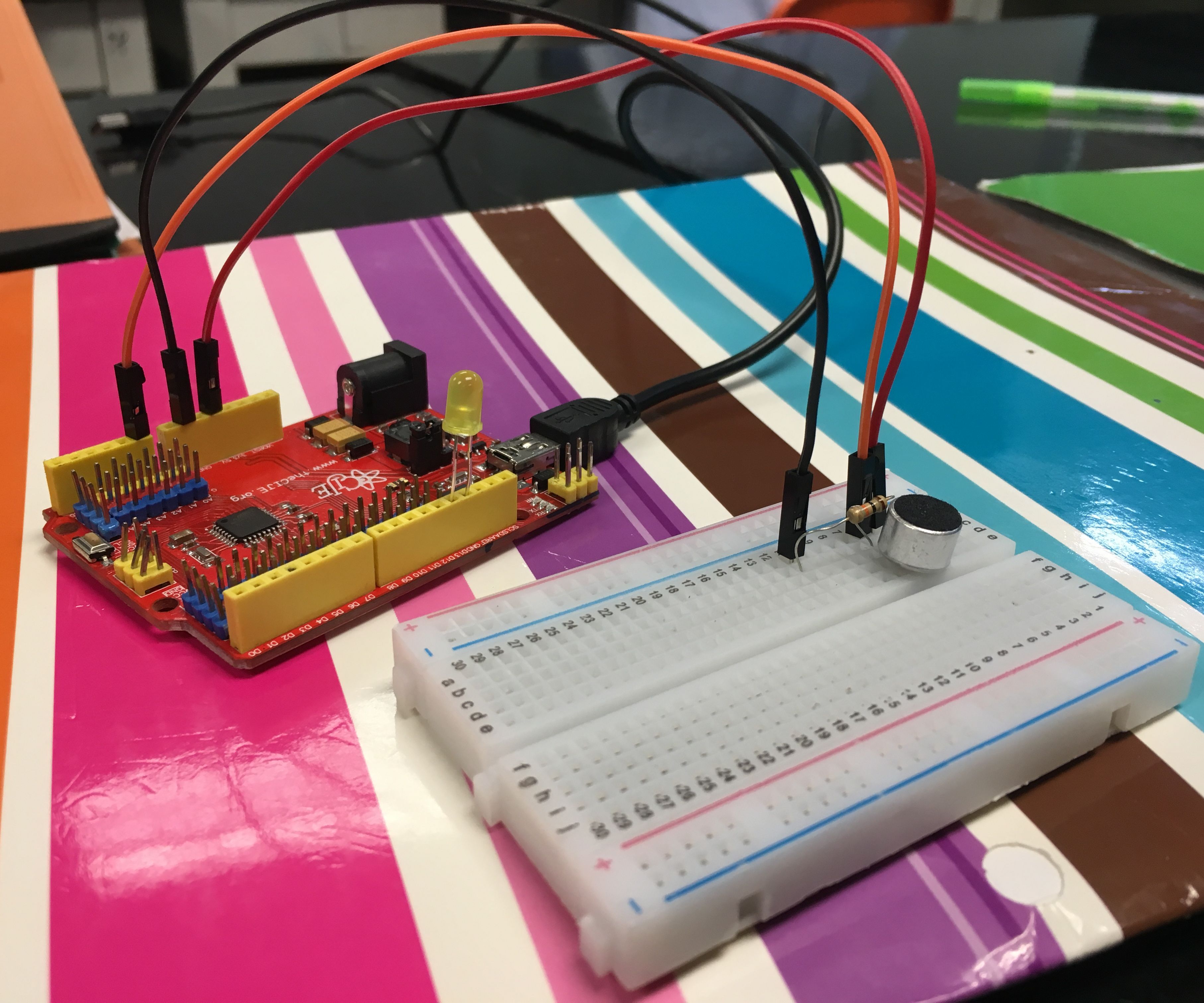

Hi, my name is Leor Oved and today I will teach you how to wire and code my new cool instructable. In this lesson you will learn how to control servo motors with a push button and an LED. You will take an LED which blinks on and off. As the LED is on, Servo1 will turn to 10 degrees and Servo2 will turn 170. When the LED turns back off, Servo1 will turn to 170 degrees and Servo2 will turn 10 degrees. This whole process is controlled by a light.

Step 2: Setup
Following are the steps to connect a servo motor to the Arduino:
The servo motor has a female connector with three pins.
- The darkest or black one is usually the ground. Connect this to the Arduino GND.
- Connect the red to VIN on the Arduino. (VIN is the input voltage to the Arduino board for an external power source (as opposed to 5 volts from the USB connection or other regulated power source).
- Connect the remaining line on the servo connector (yellow) to a digital pin (the signal) on the Arduino.,
*When using VIN as a power source, don't forget to use a 9v adapter
