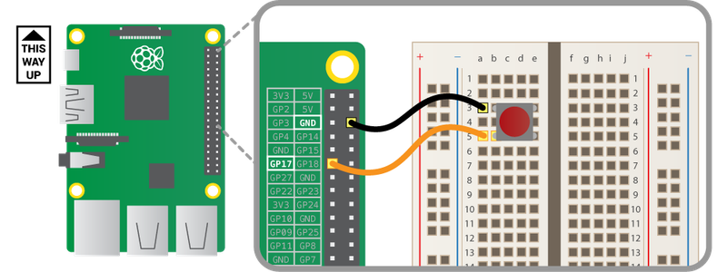

Step 2: Connect the Button
Using your breadboard and jumper leads, connect the Pi to the button as shown in the diagram below: (Image credit: RaspberryPi.org)

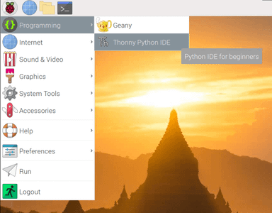

If you are using the Raspberry Pi directly, you can just open Thonny from the apps list, (Image above), but if you are using a mac or windows, use this link to download and install the app. then, type in the following code:
