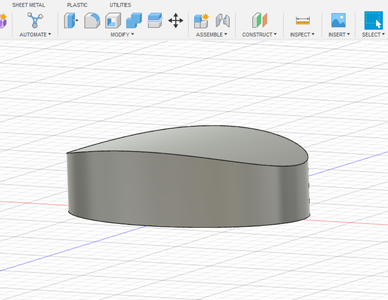

Step 2: Designing the Housing on Fusion 360
To be honest, I am an extreme beginner in CAD modeling. But thanks to my older brother who has done a lot of CAD modeling in college, I could get some good inputs about how to use the software. So these steps are going to be from the perspective of a beginner in CAD.

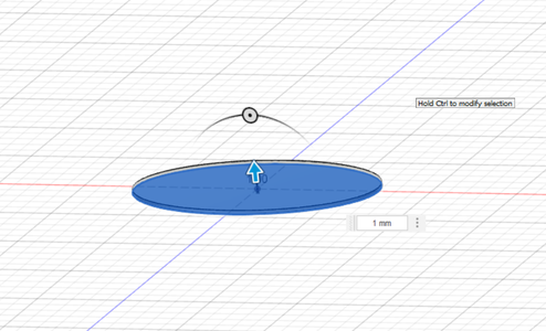

One important thing to note while making any kind of housing for something, always start with a reference sketch of what will go inside the housing. It can be a simple shape like a rectangle to have a basic idea about how big the housing should be.
We are going to place the Arduino and proximity sensor inside this housing. For this project, I am going to use a NodeMcu instead of an Arduino because it is smaller. But all the steps and codes remain the same for both. First, start with a rectangle with the dimensions of the NodeMcu (or Arduino). In my case, the nodemcu measures 25mm x 45mm. I created another rectangle for the proximity sensor which measures 20mm x 40mm. The second rectangle is inside the first one because I want to place the proximity sensor on top of the NodeMcu. This is our reference geometry and we will draw the shape of the housing around this. When taking measurements make sure to measure every bit of the component that will be inside the housing. For the proximity sensor, the two LED bulbs and the pins on the back should be considered while measuring.

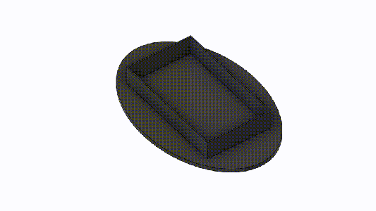

Now create a new sketch and draw the housing around your reference geometry. It can be a simple rectangle, but I am making an ellipse to give it a cooler look. Now you can exit the sketch and extrude the ellipse. The height of the extruded part should be slightly greater than the combined height of the nodemcu and the proximity sensor. In my case, the total height measured 10mm. But I created a 20mm extrude because I will be creating a curve on top to further improve its design. To make the curve, you can create a sketch on the side plane with the shape you want to cut out from the top. I created an arc at a height of 15mm from either side of the extruded ellipse. Then I closed the arc and extruded it. Fusion automatically detects that you are trying to cut the ellipse and removes the material. Now it looks much cooler. Finally, I created a shell out of the body and removed the bottom surface. I have kept the wall thickness at 0.5mm.

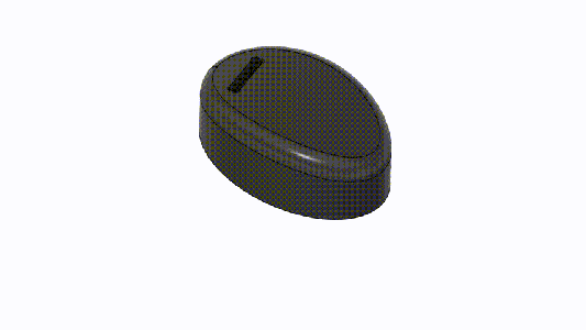

Step 3: Some Additional Touches to the Design
Now that the main housing is almost done, we need to cut a slot for the proximity sensor to peek through. The two bulbs of the proximity sensor need to peek outside from the top to detect your head when you perform push-ups. For this, I used the original reference sketch to figure out where the slot should be positioned. Then I sketched a rectangle at that place. I then extrude-cut the rectangle through the housing to create a hole for the proximity sensor. Now you can say the housing is complete, but I wanted to add a few more touches. Firstly, I added filets to all sharp edges and corners of the rectangular hole. Then I created an extrude around the hole to hold the bulbs of the proximity sensor in position. This will also prevent any reflections of IR beams inside the housing. To create this extrude, I projected the hole shape to a new sketch and offset it outward by 0.5mm to create a rectangular frame. I then extruded it towards the inside.
Step 4: Designing the Base Plate
This is the part that will hold the electronics in place and the housing will come on top of this. To make the base plate, I sketched the same ellipse on the top plane. Then I extruded it by 1mm. I thought making the base thicker would be a good choice. Then I sketched another rectangle with the dimensions of the NodeMcu on top of the base plate ellipse. I then offset it outwards by 0.5mm to create a rectangular frame. Make sure to create the offset outward and not inward. Because the inner wall should be the same dimension as the NodeMcu otherwise it will not fit in! Then I extruded the rectangle frame to create a nice place for the nodemcu to slide in. This time, we should not add filets to any edges, even if they are sharp. We need to leave everything as it is so that the components can fit in smoothly.

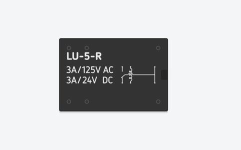

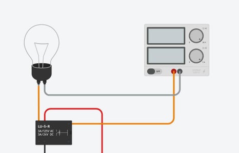

Step 6: Wiring the Relay
Great, now let’s add the relay that will control music playback. In this case, it will be a single pole double throw (SPDT) relay. One pole and two throws make up a single-pole double-throw (SPDT) relay. One throw is regarded as normally open (NO) and the other as normally closed (NC) based on the pole's default position. You can see this from the diagram on the relay. Notice there is a coil and a switch symbol to its left. To the right of the coil is a T-shaped symbol. To understand how to make the connections, we need to understand how a relay works. Basically, a relay consists of a coil of wire and a metallic switch beside it. By default, the switch is closed to the Normally Closed (NC) contact and open to the Normally Open (NO) contact. When electricity is applied to the relay’s coil, it creates a magnetic field that pulls the switch towards it such that the switch now closes the NO contact and opens the NC contact. This way the relay operates like an electronic switch. By applying a small power to its input, it can switch a much heavier load on or off.
So now it should be pretty easy to understand how to wire up the relay. First, we will connect the coil pins of the relay to the Arduino’s pin 5 and GND. I have chosen pin 5 as the relay pin here. Now, we will connect the music output between the Normally Open (NO) pins of the relay. Here, I am using a light bulb to represent music playback. When the bulb is on, music is playing, and when it is off, the music stops. So, one terminal of the bulb goes directly to the power supply, and the other goes to the power supply through the NO and COM (common) pins of the relay. Great! We are done designing the circuit. Before we can try it out, we need to program the Arduino.

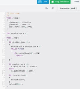

Step 7: Programming the Arduino: Basics
This is where we tell the Arduino how to control our music playback based on data from the proximity sensor. If you are already familiar with programming in C (like me), it should be fairly easy to do this. The program is pretty simple in my opinion so even beginners should be able to understand it. In any case, I will upload the INO file here so that you can directly upload it to your board.
For those who already know to program in C, here are some quick tips to get started with Arduino programming.
  1. Every Arduino program has two functions: The setup() and the loop().
  2. The setup() function will run only once after the Arduino is powered ON.
  3. The loop() function will run indefinitely after the setup() function is executed.
  4. Write your main code in the loop() function and write parts of the code that needs to run only once in the setup() function.
  5. It is a good practice to mention which pins are for input and which are for output in the setup() function.
  6. The syntax to output something from the Arduino is given by digitalWrite()
  7. The syntax to input something to the Arduino is given by digitalRead()
  8. The syntax to read and write in analog form instead of digital is given by analogRead() and analogWrite() respectively.
Those basics should help you get started with this project easily. Now let’s go through the program I have written (After failing like five times).

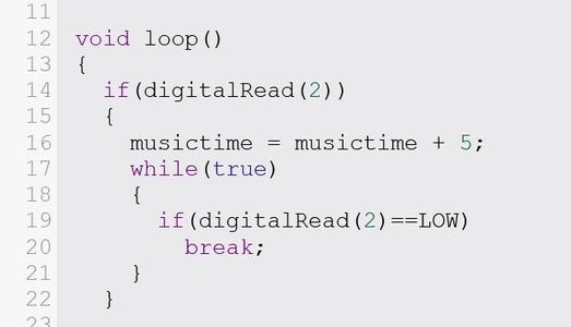

Step 8: Programming the Arduino: Detailed
First, in the setup() function, I have mentioned that pin 5 is for output and pin 2 is for input. Then I set pin 5 to LOW. LOW means OFF and HIGH means ON. The reason I set pin 5 LOW is that initially, it starts with 0 reps of push-ups so the relay needs to be OFF.  I have created a variable “musictime” that saves the amount of time music playback needs to be ON. I initially set it to 0 because of the same reason - there are no reps yet. That’s all for the setup() function!
In the loop() function, we will start with the main logic. We know that when the proximity sensor detects something (our face), the Arduino has to register a rep. So we start by saying “if pin 2 gets some input, register a rep)” For this, we use the digitalRead() function, and inside, we increment “musictime” by 15. This way, we have added 15 seconds to our music playback time. Then we enter a while loop. This is to wait until the proximity sensor is not detecting our face anymore. Or in other words, we have pushed back up. So we break the loop when the proximity sensor no longer detects our face and this completes one rep. Finally, we trigger the Relay ON if “musictime” is greater than 0. If not, we trigger the relay OFF. And finally, we decrement “musictime” by 1 and add a delay of 1000 milliseconds. This means, every iteration of the loop() function should take roughly 1 second to run and every time, we reduce the music playback time left by 1 second. Also, we only decrement “musictime” by 1 as long as it is greater than 0 because we don’t want it to go negative.
And that’s all for the code!

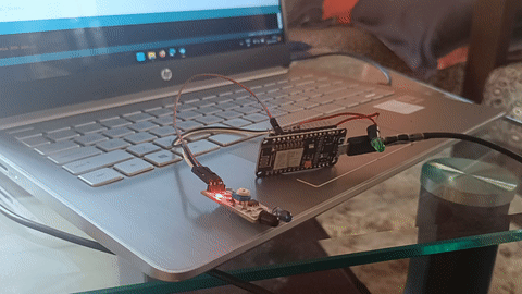

Before connecting the proximity sensor, we have to upload the code to Arduino. This is as simple as opening the code we wrote on Tinkercad (or you can grab it from this Instructable) on Arduino IDE, and clicking on “Upload” (Right arrow symbol).
Now we will start by connecting the proximity sensor to the Arduino. Like the previous step, we wire it up using the corresponding pins shown in the diagram. If you refer to the picture in this step, you can see I have connected the D0 pin of the proximity sensor to pin 2 of the Arduino via the yellow wire. Next, I have GND of the proximity sensor connected to the GND of the Arduino vis the brown wire. Finally, I connected the +5v (Vcc) of the proximity sensor to the 5v pin of the Arduino via the red wire. That completes the proximity sensor part.
Step 12: Testing the Circuit
Before connecting the relay, I decided to test if the Arduino is working as intended. To test, we can connect an LED to the Arduino pin intended for the relay. So, the LED goes to pin 5 and GND. Once that is done, we can power the Arduino either from an external power source, or the PC. When you first power it up, the LED should remain OFF. Only when you bring an object (like your hand) closer to the proximity sensor and take it away, the LED should light up. It should stay ON for 15 seconds and then turn OFF. Now if you again bring your hand close to the proximity sensor and take it away, and repeat it once more (so two times in a row), the LED should remain ON for 30 seconds. This way, every time you bring your hand close to the proximity sensor and take it away, 15 seconds should be added to the LED’s ON time. If it does exactly that, the Arduino is working perfectly as expected. If not, there is either a connection mistake (check your wiring) or a logical error in the code.
Another reason can be the proximity sensor is not tuned to the right distance to measure. This can be easily solved by rotating the potentiometer on it (A white plastic screw-like thing) using a screwdriver until it detects your hand perfectly.
Notice the LED only turns ON after you take your hand away from the proximity sensor. This is completely normal and is the nature of the code I have written. But something weird I noticed was the hand needs to be close to the proximity sensor for at least about half a second. If you take it off instantly, it doesn’t work. I could not figure out why this happens but this doesn’t cause any major problem with its function.

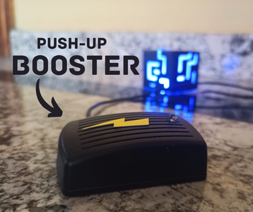

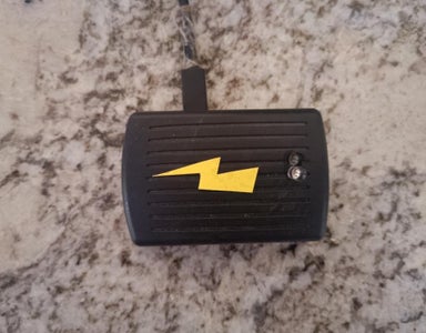

Step 15: Putting It All Together
Ideally, we should now 3D print the housing we designed and mount all components inside. Unfortunately, I don’t have a 3D printer and neither are there any 3D printing services that will deliver my print soon. So I decided to build the housing by myself at least as of now.
For this, I used a broken wall adapter because it had the perfect size and shape for my design. I first mounted all the components on the base with double side tape. My wire management isn’t great, but the inside will not be visible anyway. Also, I bent the proximity sensor bulbs upwards. I then made two holes for the proximity sensor bulbs on the upper housing and stuck it to the base with glue. Finally, I added a yellow cardboard bolt symbol to make it look cooler. And that’s all for the build! By the way, I made a hole on the side of the housing for the NodeMcu and speaker control wires to pass through.
Step 16: Final Thoughts
This was definitely one of the biggest projects I have done. I am happy to see it works just as I thought it would when I started to build this. It was fun throughout the build and I am looking forward to building more such cool stuff in the future! But no matter what, there are flaws in this version of the Push-up Booster. Firstly, the speaker can now no longer be used for other purposes. Even if you want to listen to music casually when you are relaxing, it won’t play unless you get up and start doing pushups. Well on the flip side, it will give you stronger arms sooner so that's a plus XD. Another problem is the slow registering of reps. For some reason, it takes about half a second for the proximity sensor to register a rep. I don’t know why this happens but will add an update once I figure out a solution to this problem.
Anyhow, as of now, it is a perfect workout gamification device for me and I am looking forward to improving my rep count with this!
