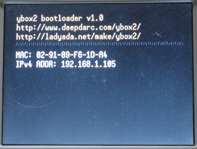

Ok, now that you have a YBox that is ready to go, plug in the Ethernet, RCA and power. You should see the bootloader screen for the YBox.

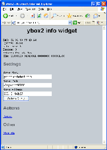

That's right, your YBox is running its very own little webserver. Yaaay. Open up a web browser, and go to the IP address listed on the screen (Make sure you are connected to the same network as the Ybox). From here, you can configure the YBox to do your bidding.

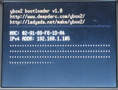

curl http://thingnumber1/stage2.eeprom -T thingnumber2.binary
Where thingnumber1 is the IP address of your Ybox, and thingnumber2.binary is the filename of the widget you wish to upload. Some lights should blink, and some dots should flash on your screen, and then your terminal will say 'Done' and some other junk. This means that the Ybox now has your widget.

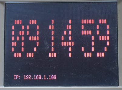

By unplugging and plugging in your YBox. Then, bask in the glory of the program you uploaded!
