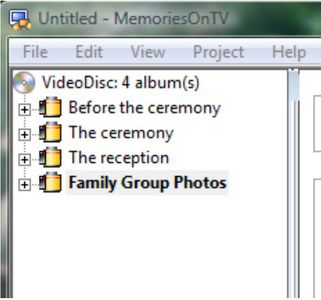

1. Start by opening MemoriesOnTV4 and create a new project. Rename “Album 1” to the first slideshow video, and then add additional albums and rename to your slideshow videos until all have been included. Mine looked like the first photo above.

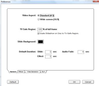

4. In MemoriesOnTV4, go to “Edit” and “Preferences” to set the appropriate DVD format specifics. We’ll be creating both aspect ratios eventually (4:3 and 16:9), so choose which one you want to do first. Set the “TV Safe Region” to 85% - I’ve found that the majority of standard TVs display the best results with this setting. (third photo)
5. Set the “Video Option” (see below) appropriately (NTSC for USA, PAL for Europe, etc.). Next press the “Burn” tab and select “Generate video disc image” and set the “working folder” to the appropriate folder of those you just created (standard TV or wide-screen). Check the “clear cache before generating the image” and then “Start.” After creating the first disc image, go back and reset the “Video Aspect” to the opposite format, etc., and create the other disc image. (fourth photo)

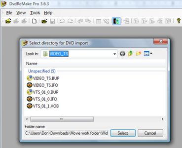

1. Open DvdReMake Pro and select “File”, “Import DVD”, and navigate to the first movie folder “Wide-screen format.” Select the “Video_TS” folder (see below) and let DvdReMake Pro do the import. Repeat this process with the “Standard TV format” folder. (first photo)
2. After you are done, the screen will look something like the second image above, with the two imports listed as “project 1” and “project 2.”

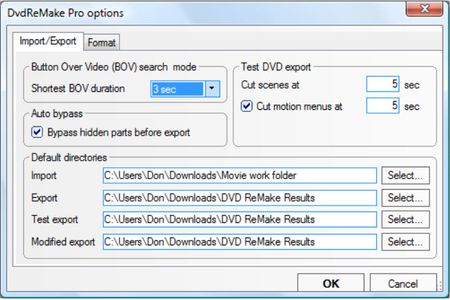

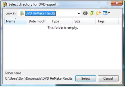

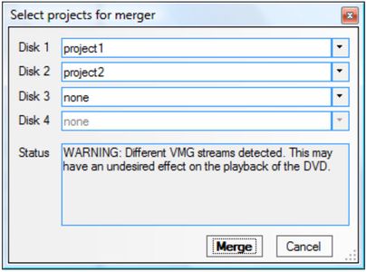

3. Next, we need to tell DvdReMake Pro where to place the results during the merge process. Select “Tools”, “Options” and select the appropriate folders. Assign all four fields, “Import”, “Export”, “Test export” and “Modified export.” (third photo)
4. Select “Tools”, “Merge DVDs…” and you get a window to confirm the merge process (fourth photo). Press “Merge”. This part of the process is very quick.
5. You now will have a “project 3”. (fifth photo)

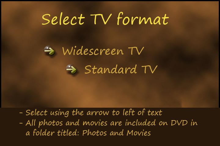

Step 5: (Optional Step) Build a Customized Start Menu for DVD
You can find directions on how to make your own customized menus from the DvdReMake web site (http://www.dimadsoft.com/dvdremakepro/index.php). Here is the basic procedure.
1. Download the blank menu images for your region from the DimadSoft.
NTSC: http://www.dimadsoft.com/dvdremakepro/dl_vob.php?f=bkNTSC
PAL: http://www.dimadsoft.com/dvdremakepro/dl_vob.php?f=bkPAL

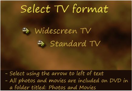

Using your favorite bitmap editor, create an image that you want to use as your menu. The first photo is an example of what I created – nothing fancy, just more descriptive.
2. Open MuxMan DVD Pro and select the “browse” button in the “Output folder” field. Navigate to “Movie work folder”, “Wide-screen-Standard Intro”, and “VIDEO_TS”. Select “OK”. Next, select the “browse” button in the “Output folder” field. Navigate to your customized menu (BMP) file. Assuming MuxMan found the file, press the “Close” button after the next screen appears (second photo). Press “Close”.
3. Press “Start” to create the dummy DVD. When Muxman is done, VTS_01_1.VOB in destination directory will contain one block with your image encoded to mpeg-2. The screen will look something like the third photo.
4. Import the newly created video files into DvdReMake Pro. After doing the “Merge DVDs”, select “Import DVD…” and navigate to the “Movie work folder”, “Wide-screen-Standard Intro” and “VIDEO_TS.” This creates a new “project” at the bottom. Press the previous project tab (“project 3” in this case). Navigate to the last “Video Title Set”, “Menus”, and then to the “root menu”. (fourth photo)
5. Place the mouse cursor over the preview image of the default menu (brown in the photo above), select the right mouse button, and select “Replace with still…” and a new window appears. Navigate to the last “Pool” and select the path shown. Select “Ok”. (fifth photo)
6. At this point, you can create the new DVD files by selecting “File”, “Export DVD…” and confirm the path to the folder inside the “DVD ReMake Results” called “VIDEO_TS” and press “Select.” (sixth photo)
| (Note: Muxman only accepts 24-bit bitmaps and that image should be of correct size (720x480 pixels for NTSC and 720x576 pixels for PAL.) |

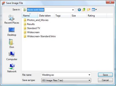

Step 6: Adding an Extra Folder to the Final DVD Using Nero Express & UltraISO
As I indicated initially, I like to include a copy of all of the photos and movies on the DVD, since I don’t use all of them in the slideshows.

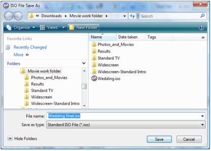

1. Using Nero Express, I simply select “Videos/Picture”, select “DVD-Video Files”, add the VIDEO_TS” folder in “DVD ReMake Results” and create a DVD ISO by selecting the “Current recorder” and selecting “Burn”. (first photo)
2. When the “Save Image File” window appears, set the “Save as type” as “ISO Image Files (*.iso)”, enter an appropriate file name (something like “Wedding - raw.iso”), navigate to your “Movie work folder” and select “Save”. (second photo)
3. Now open UltraISO and navigate to the “Movie work folder” and select the file you just created, “Wedding - raw.iso” in this example. (third photo)
4. Navigate to the folder with the photos and movies you want to add to the DVD. Simply “drag and drop” the folder into the ISO file. (fourth photo)
5. Select “File”, “Save As…” and enter the new ISO file name to save. Creating the new ISO file will allow us to make additional DVD copies after we exit UltraISO. Before exiting UltraISO, burn and test the new DVD created. (fifth photo)
