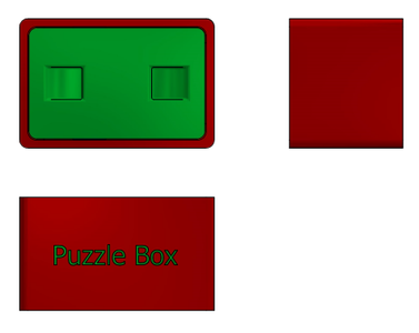

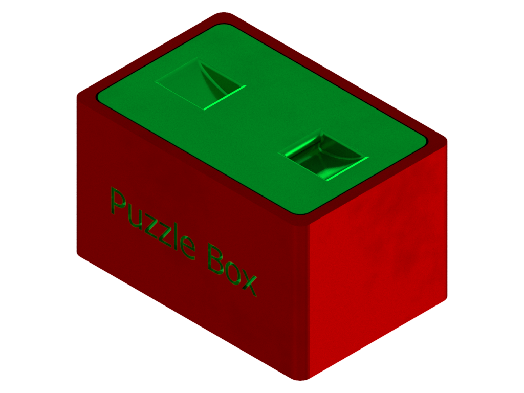

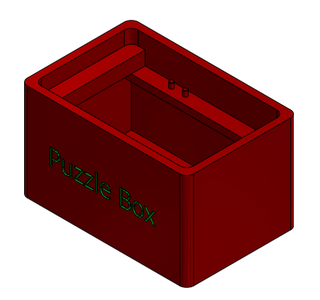

Step 2: Puzzle Box
This is the completed puzzle - ready to be solved.

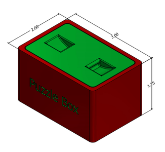

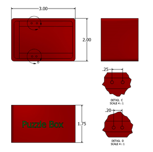

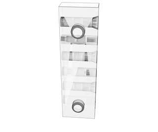

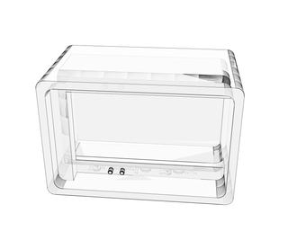

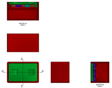

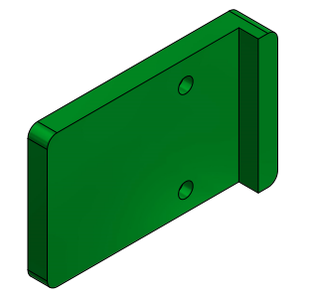

Step 3: Box
The box size was arbitrary. I figured you could get the same enjoyment out of this size puzzle without having to print a large version. Notice that I detailed the alignment pins for the nail block (next step). The different dimensions are used as keys to make sure you install it in the correct orientation.

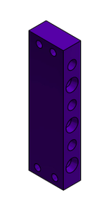

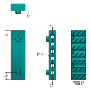

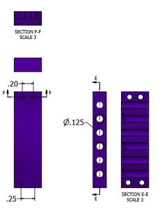

Step 4: Nail Block #1

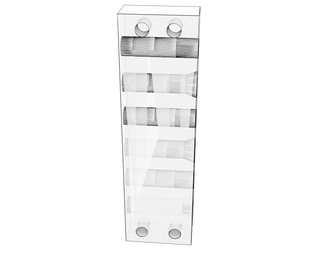

The nail block is 1/2" wide with six 1/8" diameter holes. The countersinks on every other hole help with nail alignment.

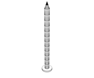

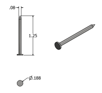

Step 5: Nails
You will need 6 nails. I'm showing a 1.25" long nail with a 0.080" shank. The hole in the block is .125" so slightly larger shanks should work. If you would like to purchase nails, here is a link. Note that I also included the STL file for the nail in case you would like to try to print your own.

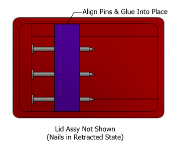

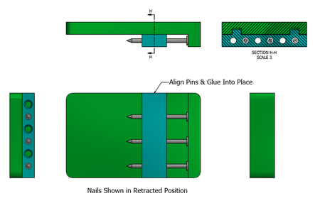

Step 6: Nail Block # 1 Install
Place 3 nails in the block as shown. Attach the block to the box using the alignment pins for orientation. You might want to hold off on fully gluing it down until final fit checks.

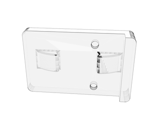

Step 7: Nail Block #2
This nail block will be attached to the lid. The construction is similar to Nail Block # 1 except the length is a little shorter (clearance for box) and it has different alignment features.

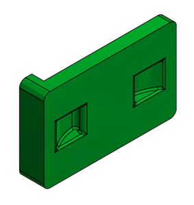

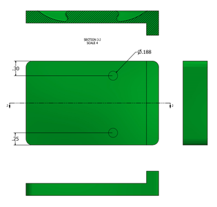

Step 8: Lid
When placed on the box, there should be 1/64" gap between the lid and box. The holes are for the nail box alignment. Again, notice the keying offset. I tried to incorporate handle grabs into the top - hopefully these work.

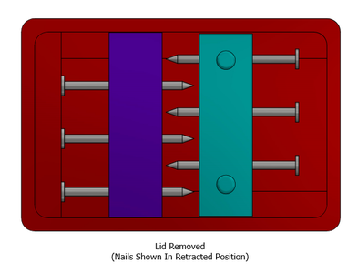

Step 10: Give It a Try
With the nails in the outward positions, place the lid on the box. Next, rock the puzzle back and fourth to move the nails. The lid should now be locked.
To open, spin the box - refer to video. After verifying that it works, go back and glue the nail blocks into place.
The first picture shows the overall completed box with cross-sections. The second picture is the puzzle with the lid removed. This is after spinning the box (nails free).
