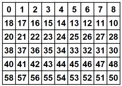

Enjoy this seemingly random arrangement of numbers that is actually a clock. My personal challenge was to make the most compact arrangement of numbers that could show all values from 00 to 60. Values are used both horizontally and vertically. A time will be a combination of two horizontal and/or vertical cell elements. Sometimes individual cells are used for different clock values, and here's where the color coding comes in.

The frame is in four parts -- the 2-part base, the grid, and the display sheet. The display sheet (with the numbers) is designed to print in two different-colored levels, the first one being made with transparent filament. The second-level (black) display numbers have to be printed on top of the transparent level because of the loose center elements in numbers 0, 4, 6, 8, and 9. Follow your printer instructions for changing filament mid-print.
(Alternately, you could create the number grid with a locked-in font, such as a stencil that has no "loose" elements. Then you could use the paper diffuser and not need a transparent level.)
Step 2: Cut the LED Strip and Attach to Grid
Cut the LED strip so that there are 58 continuous LED elements. Make sure that the input connections on the input end (top left) are included. Lay down strips of tape and place the strip as noted. Follow the guide for laying down on the tape. Be careful doing the folds for the turnarounds. Those LEDs under the folds will not be used. Placement is important because each element will have a number that will be assigned for a specific time to light up. Place the grid on top and make sure each LED is centered in its cell. Turn the grid over and secure with more tape. The better the connection to the back side of the grid, the less light bleed there will be between cells.
