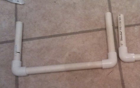

Start with your 7 10in pieces, make 3 with elbows on both sides, 2 with Ts on both sides and 2 with an elbow on one side and a T on the other

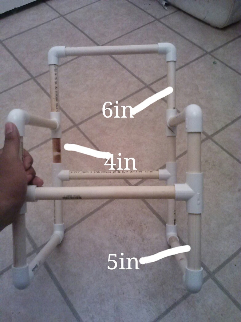

Now that you have youre fittings in place grab your 4 5in pieces and your 2 6in pieces there should be 2 pieces with the 5in pipe on both sides and one with the 6in pipe on both sides i refer to these as "u"shaped parts
Step 5:
Now what you want to do is get the 2 double T ended pipe and connect one T to one end of the 5in "u" shaped pipe you put together earlier, then grab your 2nd 5in "u" shaped pipe and connect it to the other T, do the same thing for the opposite side. And it makes youre base
Step 6:
Now what you want to do is add your 4 4in cuts to each T
Step 7: Arm Rests
Once you have youre 4in pipes connected grab the 2 parts with an elbow and T on the sides and connect it to the 4in pipe like in the picture, this makes the arm rest part of the chair.
Step 8:
Now all you're left with is the one 6in "u"shaped part, connect it to the last 2 open T fittings and you have you back rest. And youre done you can get some spray paint for plastic and paint it whatever color you want
