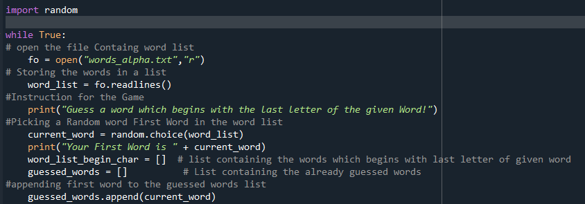

Step 1: Creating a List of Words Present in the Dictionary and Staring the Game!
The first step in the process is to open the file and read the words and store it in a list.
for opening the file open() function can be used.
fo = open("words_alpha.txt","r")
this means open the text file words_alpha.txt in read mode.
After opening the file, a list containing all the words needs to be created by using readlines()
word_list = fo.readlines()
Note : here in the list the last letter of each element is '\n' because the file is new-line-delimited.
Hence the list is created. Then we need to pick a random word from this list for the user to start the game.
This is done by :
current_word = random.choice(word_list)
note: import random library from python.
Then we will append this to a list of words already guessed by using append()
guessed_words.append(current_word)

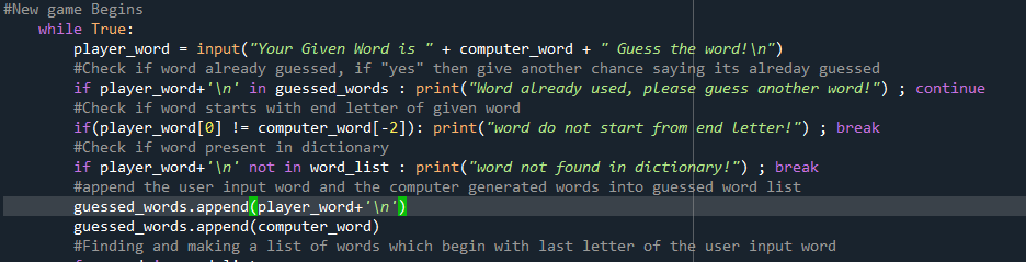

Step 2: Input the Player Word and Check Its Validity.
the player word is taken as input using input() and following things are checked:
1) if the word is already guessed : give another chance .
2) is the word starts with the ending letter of the computer word : if not, end the game the player loses
3) is the word present in dictionary : is not end the game.
if the Word is valid then append both the user word and computer word into list of guessed words.
Note : the negative index refers to the letter position from the right ( end ) of the word.
Hence [-1] means the last element, [-2] is the second from last and so on.
Note :in step one its noted that the words list has '/n' as last element [-1], hence index [-2] is used to find last letter.
