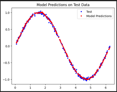

Step 2: "Hello World" Deep Learning Model Training
The "Hello World" of Deep Learning here refers to the training of a DL model for the sine Mathematical function -- train_sine.ipynb.
I guess modeling the Mathematical function sine is considered the "Hello World" of Deep Learning because
  1. The training data is very easy to generate.
  2. The architecture of the model can simply be just a few "dense" layers.
  3. When it comes to implementation, the Mathematical function sine might not be as trival as it sounds, and therefore a good demonstration of the Deep Learning "magic".

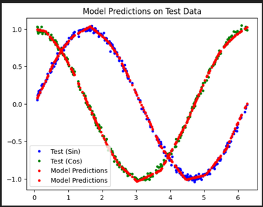

Moreover, just for fun, I extended the architecture of the sine model to output cosine values at the same time -- train_sine_cosine.ipynb.
Step 3: Highlights of "Hello World" DL Training
The target of this "Hello World" model is the sine Mathematic function for the input range from 0 to 2π (0° to 360°).
Hence, to create the data for the training the model, can generate randomized data like
x_values = np.random.uniform(low=0, high=2*math.pi, size=SAMPLES)
np.random.shuffle(x_values)
y_values = np.sin(x_values)
Since the default datatype for PyTorch is float32, first convert the data to float32, and reshape them as
x_values = x_values.astype(np.float32).reshape(-1, 1)
y_values = y_values.astype(np.float32).reshape(-1, 1)
Notes:
  1. x_values is a two-dimensional matrix, with a single column, as the input to the model is a single value (the input angle in radian)
  2. y_values is also a two-dimensional matrix, with a single column, as the output of the model is also a single value (the sine value of the input angle)
Then, 70% of the data will be treated as "train" data set, and the rest is treated as "test" data set
train_split = int(0.7 * SAMPLES)
x_train, x_test = np.split(x_values, [train_split])
y_train, y_test = np.split(y_values, [train_split])
... please refer to Highlights of train_sine.ipynb and Highlights of train_sine_cosine.ipynbfor more
