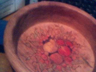

And finally, below I have gotten a picture of my latest Pyrograph. It is not as good as I could have done back when I could see detail better.
Remember the iron is hot, it not only burns wood, but skin is especially susceptible to burns. Keep the iron's point off the wood until you want it to be burning. Lift it, move it, slide it as quickly as you can without rushing, or you will pit the wood with deep burns.
