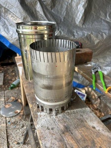

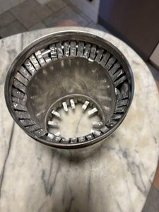

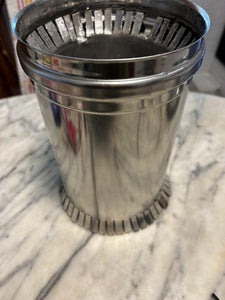

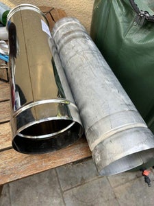

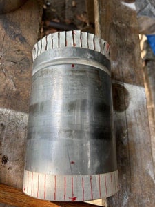

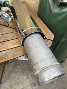

Step 1: First Two Inox Tube
Material 2 smoke inox316 pipe need to sign the cutting line to make inside wall burner diameter 15cm and 13 cm

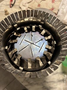

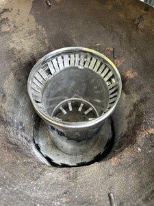

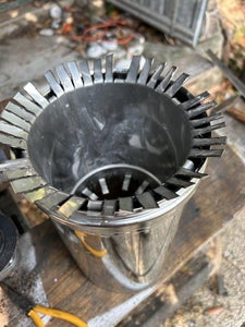

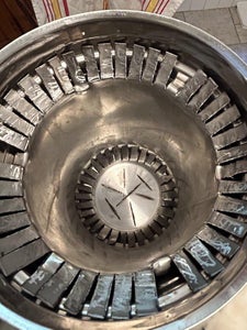

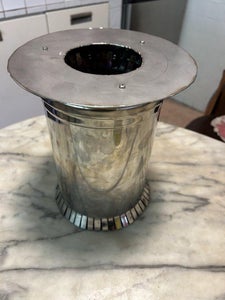

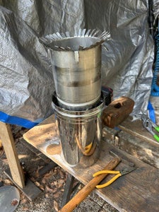

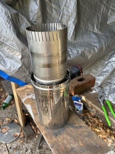

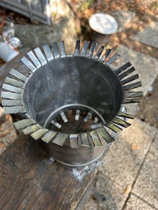

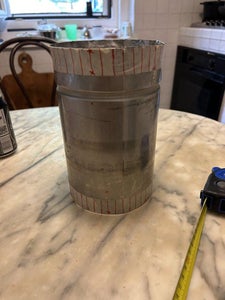

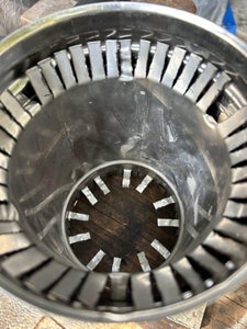

Step 2: Assembling the Burner No Drill Hole No Screw
to fit the two tubes together cut on the line and bend the slats to fit the pipes together

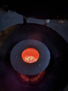

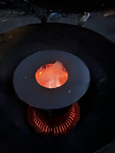

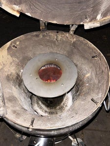

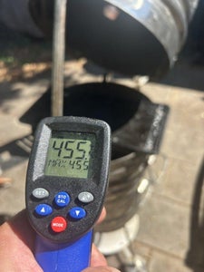

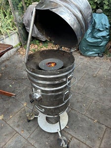

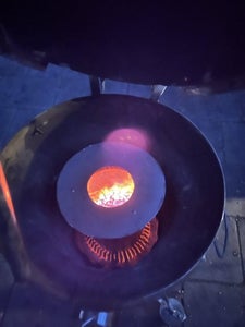

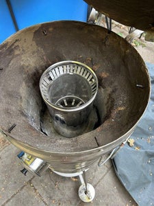

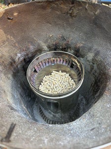

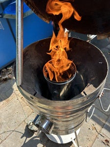

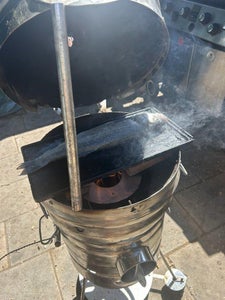

Step 3: First Test Fire
the cast iron plate reach 455 C°degree...

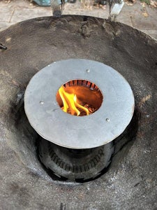

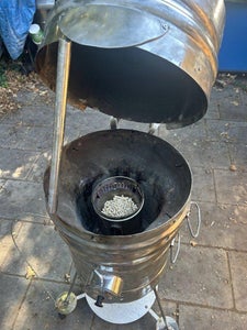

Step 4: Cooking
after 15' the cast iron plate is ready to cook
