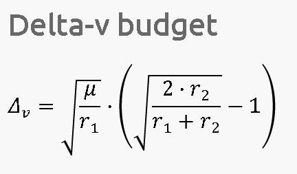

# Formula to calculate the Delta V Budget for a space mission
# Delta V Budget = (Square Root(Gravitational Parameter/Initial Radius)) * ((Square Root(2 * Final Radius)/(Initial Radius + Final Radius))-1) )

    RightSideOfFormula = ((math.sqrt((2 * FinalRadius)/(InitialRadius + FinalRadius))) - 1)
    print("The right side of the formula is: ", RightSideOfFormula)
