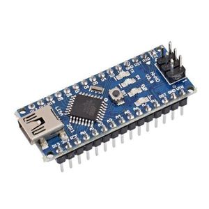

we'll be needing just a couple of components :
* An Arduino Nano.
* Two servo motors
Note: you can compromise by getting cheaper servo motors with plastic gears , but I recommend the metal geared and for the higher torch and the nicer build quality.
* A laser diode.
* Along with a soldering iron and some solder, a mini USB cable for the Arduino nano, a computer with the Arduino IDE software , and optionally Python 3 installed and of course a mouse or game controller.
