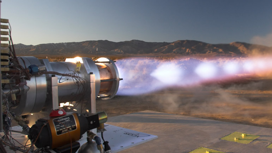

print ("This program will calculate the distance from the nozzle to the first Shock/Mach Diamond.")
import math
###  Formula for calculating the the distance from the nozzle to the first Shock/Mach Diamond:
#  Ditance = (.67 * NozzleDiameter) * sqrt((FlowPressure/AtmosphericPressure))
# Enter the NozzleDiameter, FlowPressure, AtmosphericPressure
