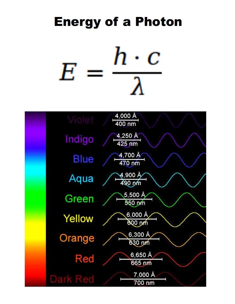

print ("This program will calculate the energy of a photon.")
import math
#  The energy of a photon forumula is:
#  Energy = [Plank's Constant][(Speed of Light)/(Wavelength of light)]
# 2 functions: solve for energy or wavelength of light
#  Function to solve for energy
#    Solve for e: enter w (wavelength)
#    Formula: energy = [(planksConstant) * (speedOfLight/wavelength)]
