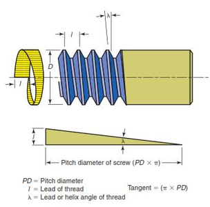

print ("This program will calculate the Lead Angle between the helix and a plane of rotation.")
import math
###  Formula for calculating the the Lead Angle between the helix and a plane of rotation:
#  LeadAngle = arctan((LeadOfHelix)/(math.pi * MeanDiameterOfHelix))
# Enter the LeadOfHelix, MeanDiameterOfHelix
