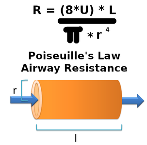

print ("This program will calculate airway resistance in a person using Poiseuille's Law.")
import math
#  Airway resistance in a person using Poiseuille Equation:
#  Airway resistance = [(8 * dynamic viscosity) * length]/[pi * (radius of pipe**4)]
#  1 function: solve for airway resistance
#  Function to solve for airway resistance
#    Solve for resistance: enter dynamic viscosity, length, radius
#  Airway resistance = [(8 * dynamic viscosity) * length]/[math.pi * (radius of pipe**4)]
def SolveForAirwayResistance():
    print ("Solving for airway resistance")
#  The pi variable is coming from Python's constant: math.pi
    pi = math.pi
    DynamicViscosity = float(input("Enter the dynamic viscosity: ") )
    Length = float(input("Enter the length of the airway: ") )
    Radius = float(input("Enter the radius of the airway: ") )
    AirwayResistance = ( (8 * DynamicViscosity) * Length)/(pi * (Radius**4) )
    print("The airway resistance is:", AirwayResistance)
