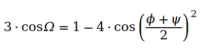

Python program that calculates the rotation angle of an alpha helix protein.
Also attached is a PDF that diagrams the formula being broken down into Python code. Code is below and attached.

#  Formula for calculating the rotation angle of an alpha helix:
#  RotationAngleAlphaHelix = arccos((1-(4 * (((cos((DihedralAngleOne + DihedralAngleTwo)/2)))**2)))/3)
