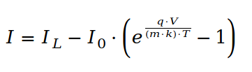

Code to calculate current delivered by an illuminated diode from a solar cell.
Includes PDF diagram of how the program broke the equation down into parts for calculation.
Python code is attached and below.

#  Formula for calculating the solar cell current delivered by illuminated diode:
#  SolarCellCurrent = (GreatestCurrent - ReverseSaturationCurrent) *
# ((EulersNumber**((ElementaryCharge*Voltage)/((IdealityFactor*BoltzmannConstant)*AbsoluteTemp))) - 1)
# 1 function: solve for the solar cell current delivered by illuminated diode
# Enter the GreatestCurrent, ReverseSaturationCurrent, Voltage, IdealityFactor, AbsoluteTemp
# Constants: Euler's Number: math.e
# ElementaryCharge: (1.60217662*(10**-19))
# BoltzmannConstant: (1.38064852*(10**-23))
