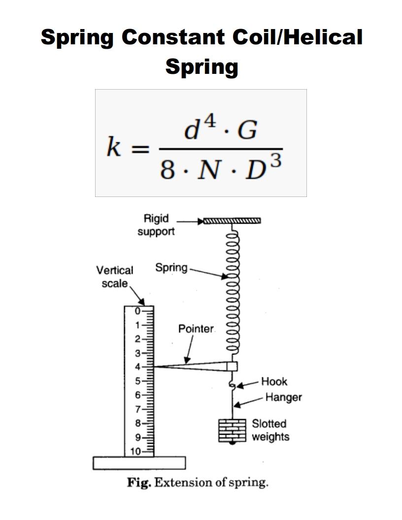

print ("This program will calculate the Spring Constant of a Coil/Helical Spring.")
import math
###  Formula for calculating the Spring Constant of a Coil/Helical Spring:
#  SpringConstant = ((WireDiameter**4) * (SpringShearModulus))/((8) * (NumberOfWraps) * (DiameterOfCoil**3))
# Enter the WireDiameter, SpringShearModulus, NumberOfWraps, DiameterOfCoil
ContinueCalculations = "y"
def CalculateSpringConstant():
    print ("Solving for the Spring Constant of a Coil/Helical Spring.")
    WireDiameter = float(input("Enter the diameter of the wire: ") )
    # Enter the SpringShearModulus
    SpringShearModulus = float(input("Enter the Shear Modulus of a Spring: ") )
    # Enter the NumberOfWraps
    NumberOfWraps = float(input("Enter the number of wraps in the spring: ") )
    # Enter the DiameterOfCoil
    DiameterOfCoil = float(input("Enter the diameter of the spring coil: ") )
    # Calculate the top of the fraction
    WireDiameter4thPower = (WireDiameter**4)
    TopOfFraction = (WireDiameter4thPower * SpringShearModulus)
    # Calculate the bottom of the fraction
    DiameterCoilCubed = (DiameterOfCoil**3)
    BottomOfFraction = (8 * NumberOfWraps * DiameterCoilCubed)
    # Calculate Spring Constant
    SpringConstant = TopOfFraction/BottomOfFraction
    print("The Spring Constant of a Coil/Helical Spring is: ", SpringConstant)
while (ContinueCalculations=="y"):
    ContinueCalculations = str(input("Would you like to continue to calculate the Spring Constant of a Coil/Helical Spring (y/n): "))
print("==================================")
print ("Thank you to www.fxsolver.com for assistance with this formula.")
