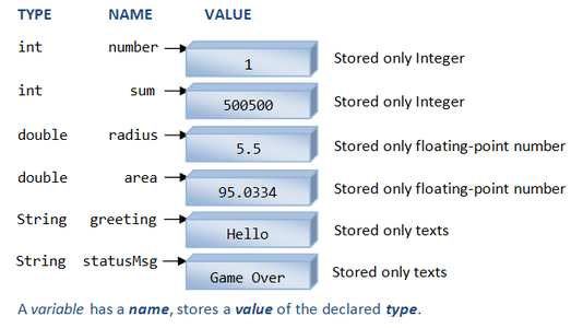

Step 8: Variable Types
As already mentioned before, there are different variable types.
It is important that we look at the different variable types before we move on to how to ask the user for input.
Integer
A integer, or for short int, is a variable that can store only whole numbers, no fractional part allowed here.
Example:
x =5print x
Float
A float is a variable that can store a number containing a fractional part.
Example:
x =3.14159265print x
String
A string, or for short str, is a kind of variable that can store characters, so, it can store text. This text must be marked by quotes, just as we already had if we wanted to pring text.
Example:
x ="Derpy Hooves"print x
