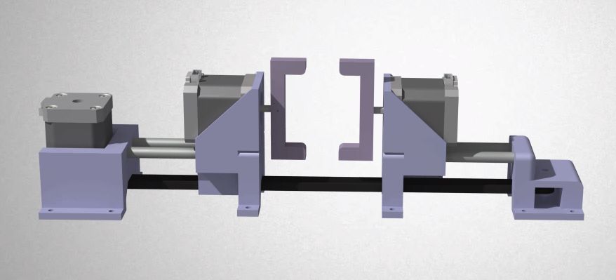

This section briefly covers how the Q-Bot even functions and where the above mentioned components are used. Below you can see a rendering of the fully assembled CAD modell.
The Q-bot works by having four motor attached directly to the Rubik's Cube with 3D printed grippers. This means that left, right, front and back can be turned directly. If the top or the bottom side need to be turned, the entire cube must be turned and so two of the motors have to be move away. This is done by attaching each of the gripping motors onto sleds driven by another stepper motor and a timing belt along a linear rail system. The rail system consists of two 8 ball bearings that are mounted into cavities in the sled and the whole sled rides on two 8mm aluminium shafts. Below you can see the sub assembly of one axis of the solver.
The x- and the y-axis are basically identical they only differ in the height of the mounting point of the belt, this is so that there are no collisions between the two belts when fully assembled.

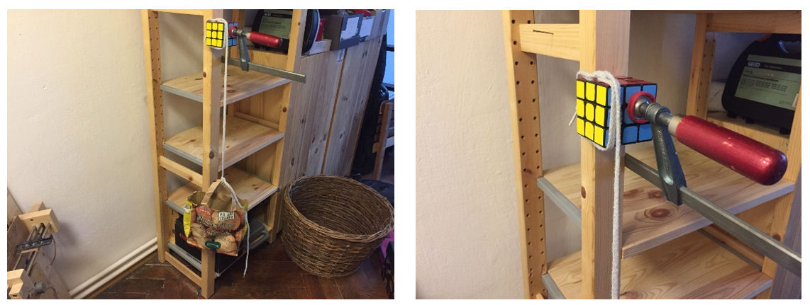

Of course, selecting the right motors is very important here. The main part is that they need to be strong enough to be able to turn a Rubik's cube. The only problem here is that no manufacturer of Rubik's cubes gives a torque rating. So, I had to improvise and do my own measurements.
Generally torque is defined by the force directed perpendicularly to the position of the rotational point at the distance r:
So, if I could somehow measure the force applied to the cube I could calculate the torque. Which is exactly what I did. I clamped my cube to a shelf in a way that only one side could move. That a string got tied around the cube and a bag attached at the bottom. Now all that was left to do was slowly increase the weight in the bag until the cube turned. For the lack of any accurate weights I used potatoes and measured them afterwards. Not the most scientific method but because I'm not trying to find the minimum torque it is quite sufficient.
I did the measurments three times and took highest value just to be safe. The resulting weight was 0.52 kg. Now because of Sir Isaac Newton we know that Force equals mass times acceleration.
The acceleration, in this case, is the gravitational acceleration. So the required torque is given by
Plugging in all of the values, including half of the diagonal of the Rubik's cube, finally reveals the required torque.
I went with stepper motors that are able of applying up to 0.4Nm which is probably an overkill, but I wanted to be safe.

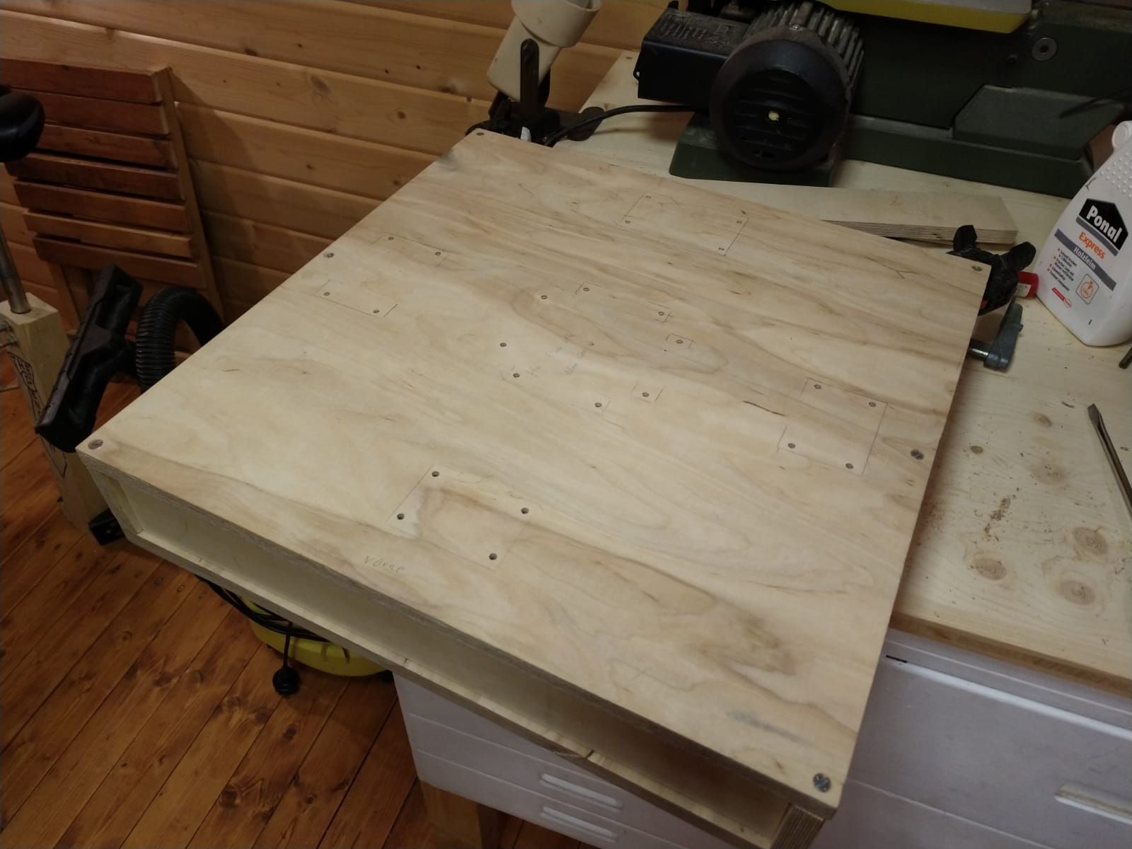

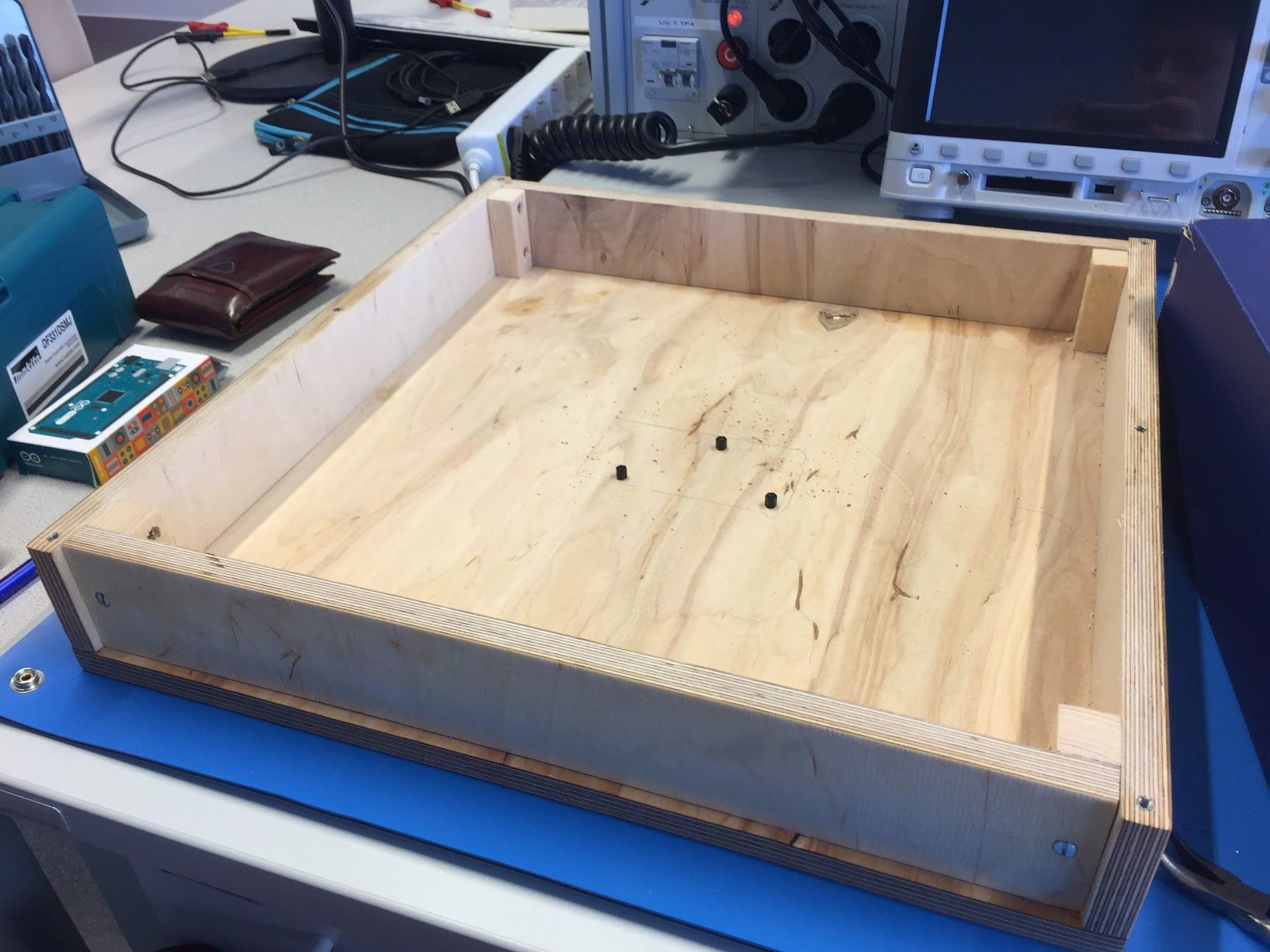

Step 3: Constructing the Base

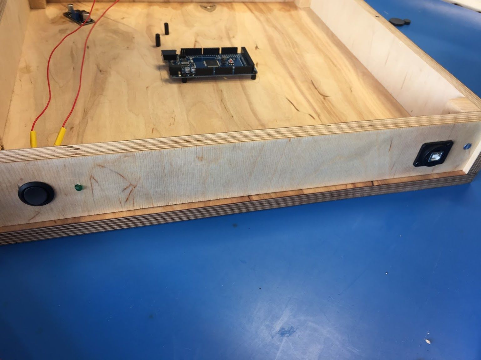

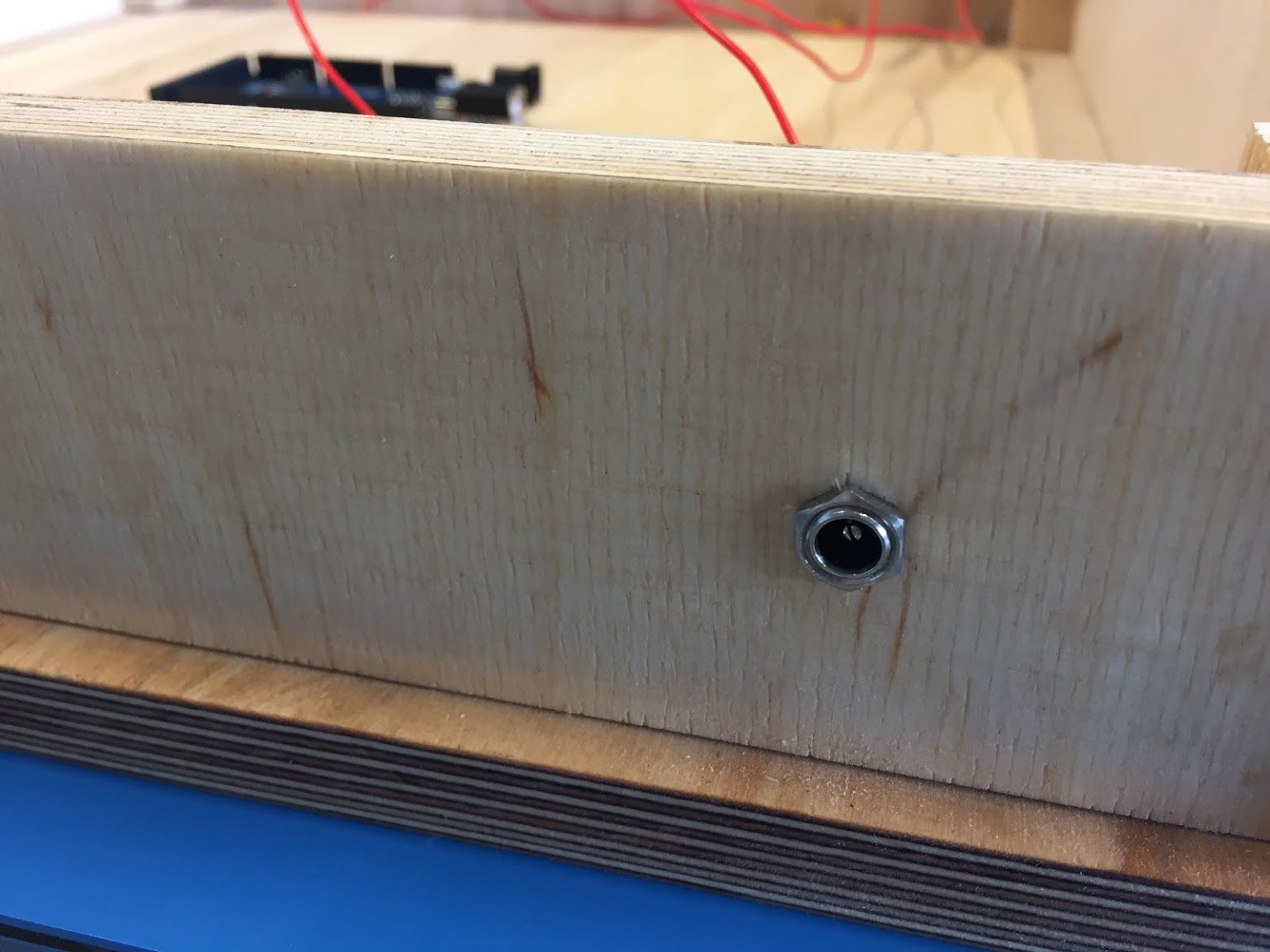

The base consists of a very simple wooden box and it houses all the required electronics. It features a plug to turn on and off the machine, an LED to indicate if it is turned on, an USB B port and a socket for the power supply to plug into. It was constructed using 15mm plywood, some screws and a bit of glue.

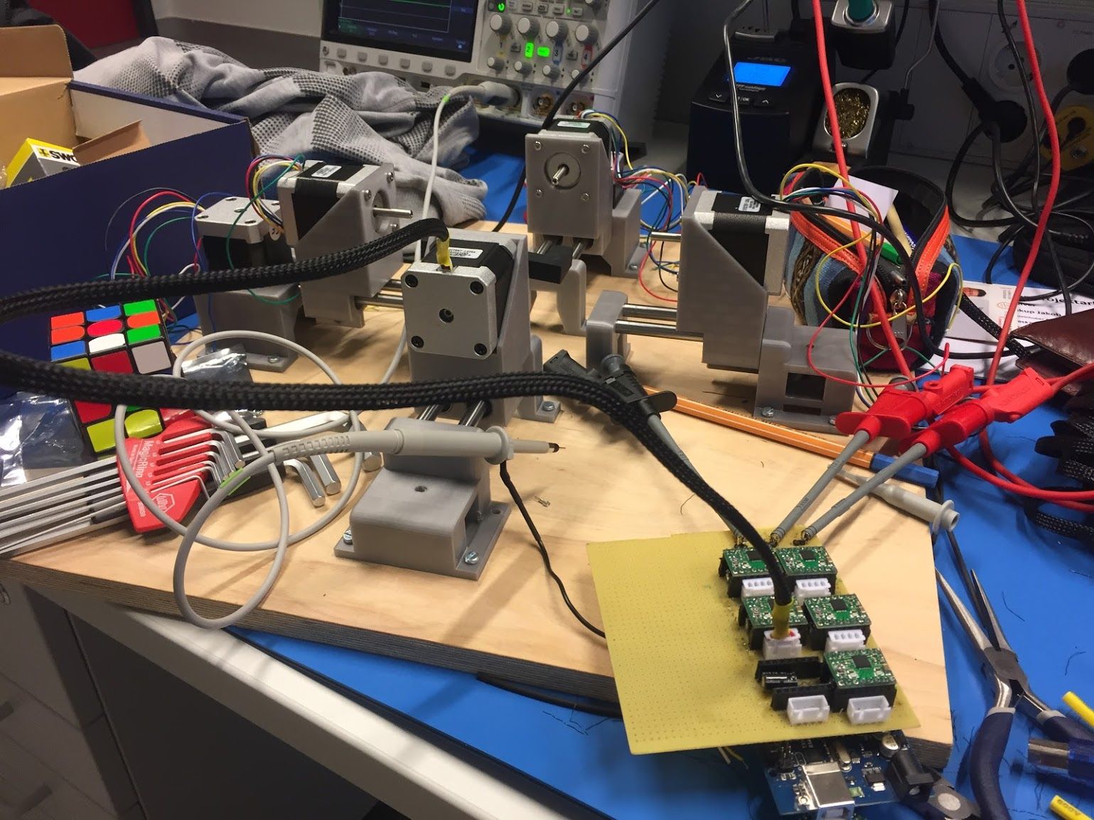

As for the electronics the project is rather simple. There is a main 12V power supply, that can deliver up to 3A of current, which powers the motors. A step-down module is used to safely power the Arduino and a custom shield for the Arduino was designed that houses all of the stepper motor drivers. The drivers make controlling the motors much easier. Driving a stepper motor requires a specific control sequence but by using motor drivers we only need to generate a high pulse for each step the motor shall turn. In addition, some jst connectors were added to the shield to make connecting the motors easier. The shield for the Arduino was firtsly built on a piece of perfboard and after making sure that everything works as it was supposed to it got manufactured by jlc pcb.
Here's the before and after of the prototype and the manufactured pcb.
