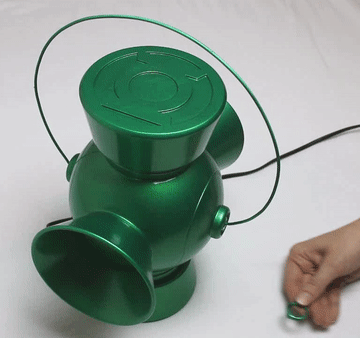

I wanted to have a Green Lantern Power Battery for quite some time. Sadly the original DC Collectibles ones are ridiculously expensive. After a bit of research I decided to build my own. Instead of just copying their functionality I decided to make it actually useable as a cell phone charger.
You can simply place your phone onto it and it will be loaded. The only requirement is that your phone can be charged with Qi (please check out Wikipedia should you want to learn more about Qi). But don’t worry if your phone doesn’t come with Qi, there are cheap adapters you can use (as you can see in the pictures I had to use one, too).
Another functionality that the Power Battery has is that you can turn on the light with a ring.

As you can see in the pictures, there are also three extra USB plugs in the back to charge more than one phone.

Congratulations you are done.
