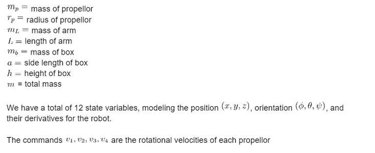

Step 3: Implementation: Quadcopter Model

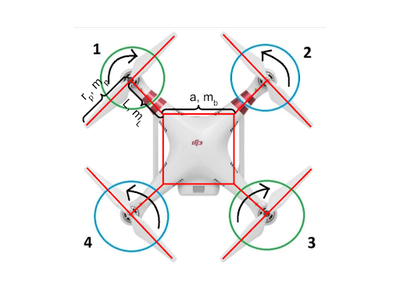

The quadcopter we are using, and any quadcopter you can find have incredibly complex dynamics due to their shape, size, density of the air, motor dynamics, etc. This quickly becomes unwieldy when attempting to generate a model of the dynamics, so we propose the following simplified model of the quadcopter.
We simplify the quadcopter into a central region in the shape of a box, 4 legs which each extend out from the corners of the box and are each attached to propellers which spin either clockwise or counterclockwise. The parameters are as shown in the diagram, with a few extra that could not be shown due to perspective; they will be attached in the image.

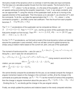

Step 4: Implementation: Quadcopter Dynamics
See Image
