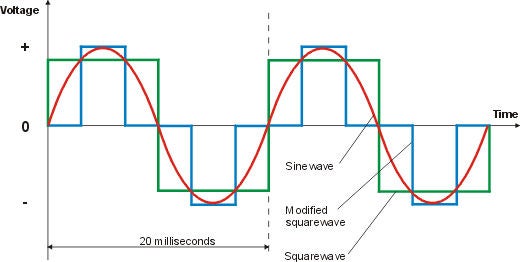

Step 1: The Waveform.
I highly recommend using only a pure sine wave inverter. All homes have motor based appliances and these need clean sinusoidal power to operate properly and ensure long life. Do not be tempted into buying those cheaper modified square wave inverter (wrongly advertised as modified sine wave!).
The best quality pure sine wave inverters produce a clean waveform and are actually safe for medical grade equipment.

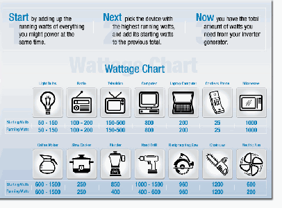

Step 2: The Power Rating.
The bigger the better. Why? For motor loads like fridges, there is a high starting current (4 to 8 times the running current) and you want your inverter to safely handle such loads. For example if your fridge pulls 300watts, buy as a minimum a 600watt inverter. In fact a 1000watt is even better but it depends on your budget.
An oversized unit will have a bigger idle current but it will last longer due to less thermal stress.

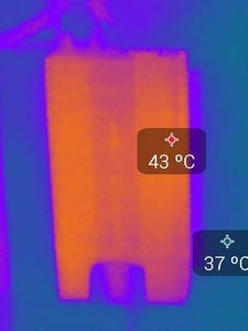

Step 4: The Internal Cooling.
I learnt this first hand that the cooling fans and or integral control circuit can fail fast and the rest of the inverter work until it overheats.
Honestly you can't tell if the cooling system will even last long. I had to remove the failed fans and externally mount new ones for easier future replacement. I also installed new programmable digital temperature controllers to manage the fans.
In the end you need to be observant with your inverters (and other off grid equipment) to know if the cooling is working.
