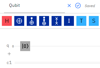

Step 1: The Qubit
What we have described here is the abstract notion of a qubit. The quantum computers you interact with in IBM Quantum use a physical type of qubit.
For a superconducting qubit to behave as the abstract notion of the qubit, we must have the device at drastically low temperatures.
Once a system has cooled to the target temperature, which takes several days, the qubit reaches equilibrium at the ground state |0>.
In the image you can see a circuit with one qubit (q0) initialize to the ground state and its Q-sphere.
Open in IBM Quantum Composer

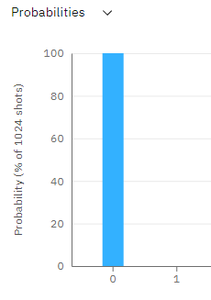

Step 2: The Standard Measurement
Here, the reset operation prepares the qubit in the |0> state, and is followed by the standard measurement.
As you can see the probability our circuit was in the ground state is 100%

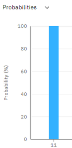

Step 4: FAN-OUT Gate
After the execution of this gate, the qubit 1, initialized to the state |0>, will have the same value as qubit 0

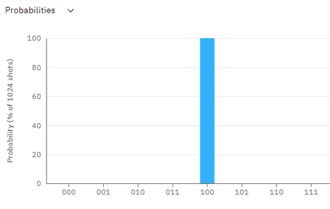

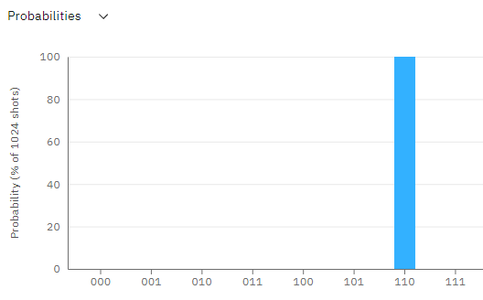

Step 5: The Toffoli Quantum Gate
A quantum gate or quantum logic gate is a rudimentary quantum circuit operating on a small number of qubits.
They are the analogues for quantum computers to classical logic gates for conventional digital computers.
Quantum logic gates are reversible, unlike many classical logic gates.
Some universal classical logic gates, such as the Toffoli gate, provide reversibility and can be directly mapped onto quantum logic gates.
The Toffoli gate has 3-qubits inputs and outputs.
Toffoli (q0,q1,q2) = (q0),(q1),(XOR (q2, AND (q0,q1))
INPUTSOUTPUTS
q0q1q2q0q1q2
000000
001001
010010
011011
100100
101101
110111
111110
The inputs in the image are red colored and the outputs are green colored.
The barriers is just only for visualization purpose. To separate the initial inputs from the rest of the circuit.
Please, pay attention how this final state is represented in the probabilities graph.
Go to the composer and proof how the outputs change when you change the inputs

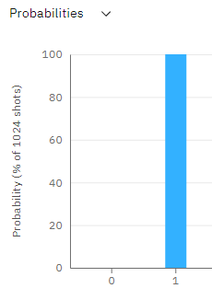

Step 6: The NAND (AND) Gates From the Toffoli Gate
The classical NAND gate is not reversible, so we have to use the universal reversible Toffoli gate to create the quantum NAND gate.
Let us have a look to the truth table of the Toffoli gate.
INPUTSOUTPUTS
q0q1q2q0q1q2
000000
001001
010010
011011
100100
101101
110111
111110
If you pay attention, the inputs q0 and q1 (red) are all the possibles values for two classical bits and the output q2 (blue) implements the NAND gate. The input q2 (red) always is 1 and the ouputs q0 and q1 (blue) replicate the inputs values.
In the circuit in the image you can see the qubit q2 initialized to the ground state and after that a NOT gate to flip its state to |1>.
So, the quantum circuit implements:
Toffoli (q0,q1,1) = (q0),(q1),(XOR (1, AND (q0, q1))) = (q0),(q1), (NAND (q0,q1))
To implement the AND gate just only apply a NOT gate to the qubit q2.
AND (q0,q1) = NOT (NAND (q0,q1))

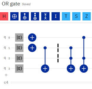

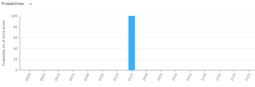

Step 7: The OR (NOR) Gates From the Toffoli Gate
Again, the classical OR gate is not reversible, so we have to use the universal reversible Toffoli gate to create the quantum OR gate.
We can obtain it in the following way:
Toffoli (1,q1,Toffoli (q2,q1,q2)) = (1),(q1),(XOR (q2, AND (q2, q1))) = (1),(q1), (OR (q2,q1))
In the circuit:
  • q0 is always |1>
  • The circuit implement1 OR (q1,q2) and the result is present in q3
  • In the image the gate is showing OR (1, 0) = 1
To implement the NOR gate just only apply a NOT gate to the qubit q3
NOR (q1,q2) = NOT (OR (q1,q2))

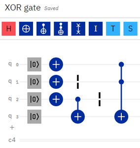

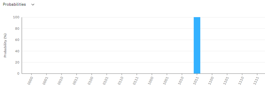

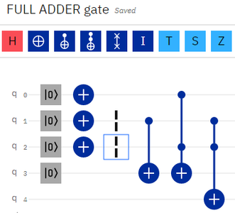

Step 8: The XOR Gate From the Toffoli Gate
We can obtain the XOR gate from the Toffoli gate in the next way:
Toffoli (1,q1,q2) = (1),(q1),(XOR (q2, AND (1, q1))) = (1),(q1), (XOR (q2,q1))
In the circuit:
  • q0 is always |1>
  • The gate implement XOR (q1,q2) and the result is present in q3
  • In the image the gate is showing XOR (1, 1) = 0

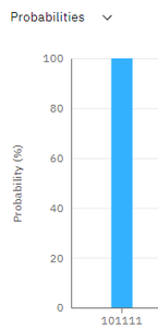

Step 9: Quantum Circuit to Implement a Boolean Function
One we have create the OR, AND and NOT gate we have a set of universal quantum gates to implement whatever logical boolean function.
In the image you can see the circuit that implements:
f = (q0 AND q1) OR q4
In the circuit:
  • q3 is always |1>
  • The circuit implements f (q0,q1,q4) and the result is present in q5
  • In the image the gate is showing f (1, 1, 0) = 1
