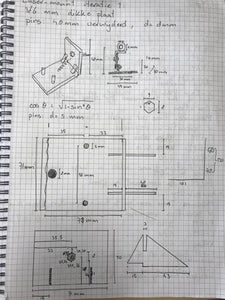

For the laser holder, a design was created to allign it with the prism holder (see instructable part 1). You can view the pictures and file to see what was done to create this, as well as the sketch.
Also, it is needed to saw two 8mm bits out of the wooden sticks before continuing.

With the lasercutter having done it's job, we first plug in the little poles into the small holes of the baseplate.
Then some glue has to be added to the slits of the triangle supports. Slide these into the plate with the single hexagonal hole. Glue the plate with supports to the baseplate, on the side without a large hole.
And finaly, add the small strips of wood to the sides to create some rails to keep everything in a straight line.
