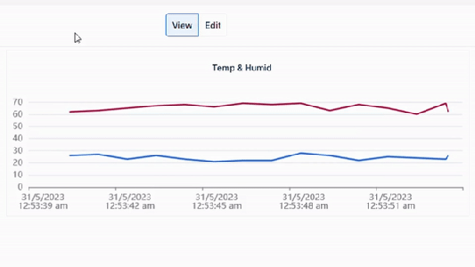

Now that we were able to fetch for real-time data from the ESP32 board and view it on the table of Qubitro. Let us use the visualization feature to plot a graph of the data. Trust me, it takes seconds to setup the whole thing.
  • Go to Dashboards, and create a New Dashboard. Give it a name.
  • Once created, open it and go to Edit > Add Widget > Charts.
  • Click on the new widget > three dots (settings) > Customization.
  • Accordingly, select the data source, chart type and colour for data variables. Follow the below images for reference, and final Graph.
Data source example above
Data Point example above
Finally, I received the above graph based on a 30-minute data logging. If we head back to the main dashboard page, we can have a proper view, and with a view configuration, receive live data in realtime on Qubitro.
  • In the dashboard, click on the chart widget we created, click on edit and drag it to the middle.
  • Stretch and play with the widget according to the need. Resizing it for proper viewing. Remember to save it.
If you are facing trouble with viewing the data with 4 points in the graph period, you can change it in the View Mode's configuration of the graph widget.
Now, using this we can view the data of our device based on our needs!
